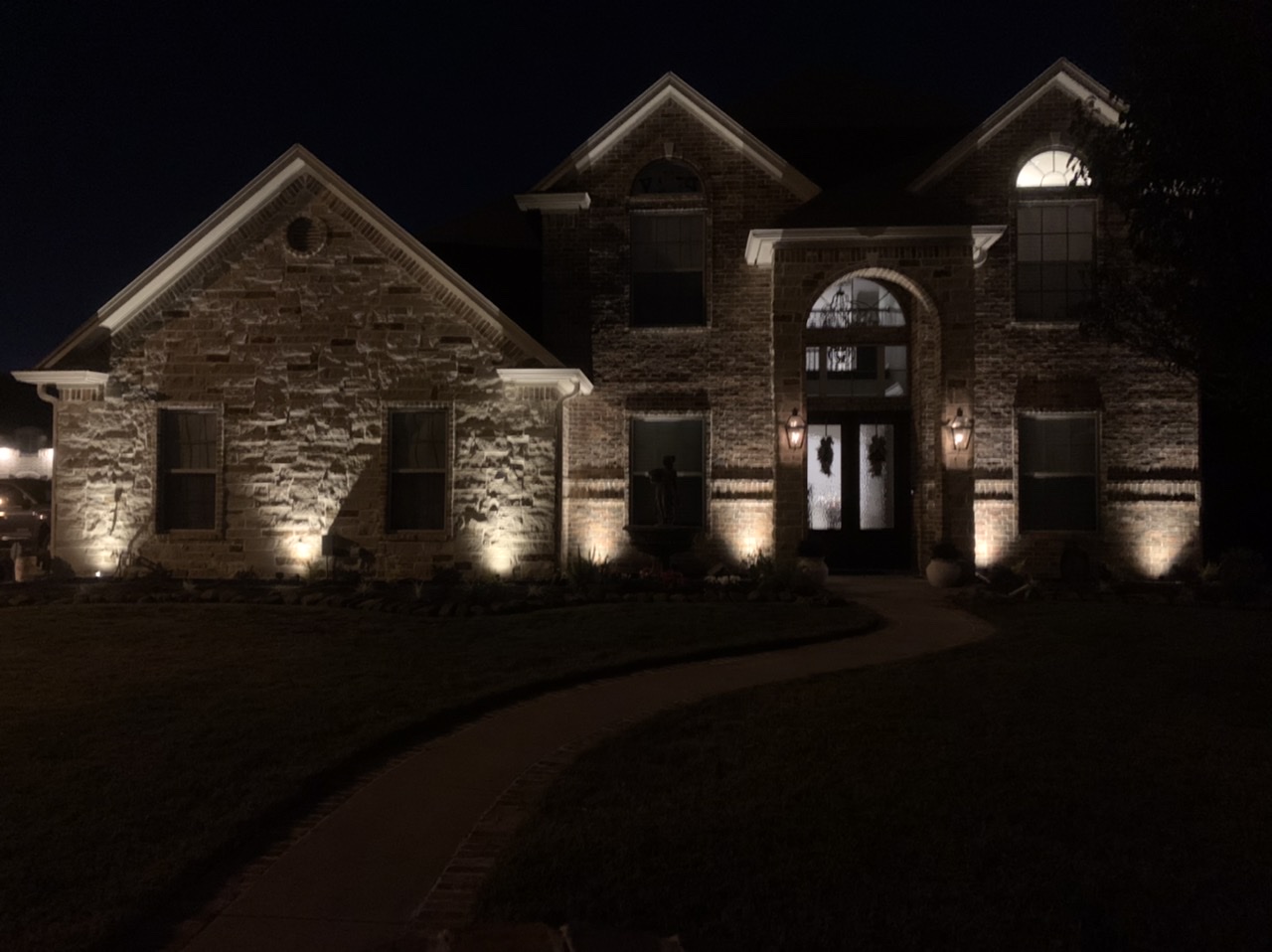

    Installed the wall grazing spots, 2 watt, 2700k, all 38 deg except for 2nd light from left it’s 60 deg. The iPhone is auto adjusting the photo, actually not as white. I think I’m going to swap out for 3 watt. 38417807-25E4-4B98-87A3-8C7BA78C647A.jpeg
  9. Mesodude2
    693
    Looking great, so far. It looks like the beam spreads fit just fine. I can see that the horizontal brick detail on the right is preventing some light from reach higher up. Your solution might address that.
  10. Eric1960
    Eric1960 New Member
    Oct 26, 2020
    16
    10
    Mesodude, will bringing the light further from the wall solve that, and still provide grazing?
  11. Mesodude2
    693
    Yes and no. You can stake the fixture further enough away from the wall to aim it at an angle that makes that shadowing less pronounced but once you’ve significantly exceeded about a foot from the wall, you’re officially in wall washing territory. You might still be able to “graze” the more pronounced brick work but you’ll likely lose the definition in the less pronounced brick work. A skilled lighting designer (which I’m not) could probably find an approach that enabled you to reduce the height of that shadowing and still keep grazing the facade overall (assuming that’s your goal) but it’d probably require using more fixtures and some careful lumens calculation.
