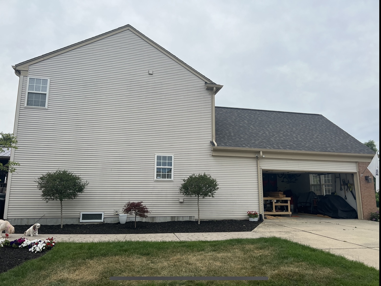

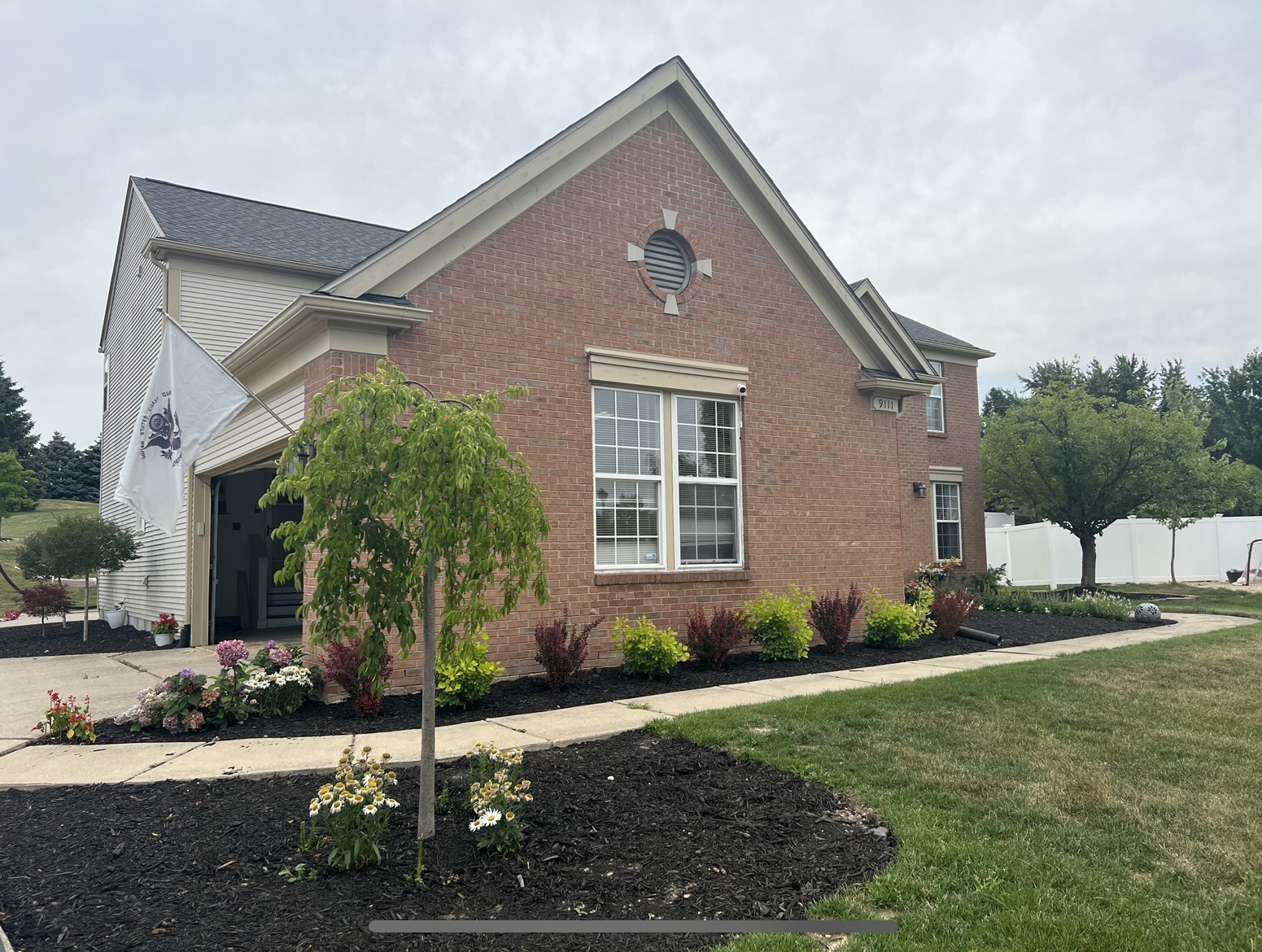

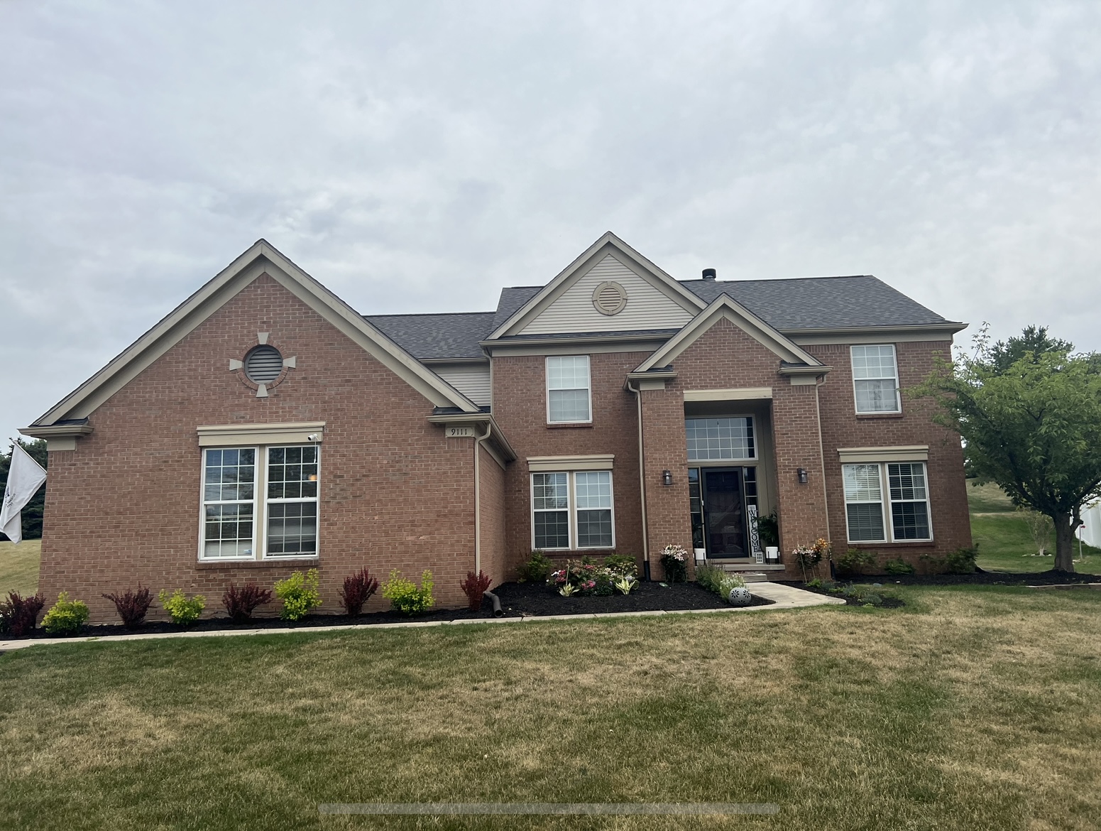

Can someone explain the difference between these 2 lights: VOLT® RGBW G4 Infiniti™ 60 Integrated LED Brass Spotlight (Bronze) VOLT® RGBW Max All-Star™ Integrated LED Spotlight (Aluminum Black) Which should I use to cast light against the wall of my house, and which should I use to illuminate trees? The Max All-Star comes with a remote but the G4 Infiniti has a remote bought separately - will the G4 remote work with the Max All-Star lights? And, could someone suggest placement for me? And what accessories I need in addition to the lights? I'm very new to this if you couldn't tell Thanks!
Hi, Carmen. The Max is designed for commercial use. It’s twice as powerful and more than twice the size of the Infiniti. Even so, the brightness of the Infiniti should be more than you need and it’s a much more compact fixture. I’ll try to post a lighting plan for you later. In the meantime, I high;y recommend you review some of the dozens and dozens of past posts in this forum for lighting plan recommendations. I’m confident you’ll find examples of homes with architecture similar to yours.
