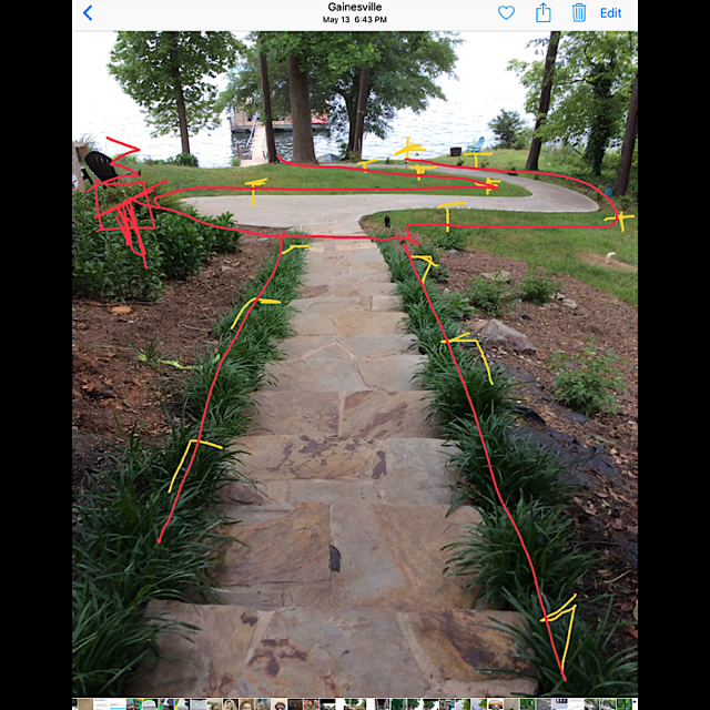

    Here are some pics. Steps that lead to path.
    The back of house I am considering 3-4 Wall Wash lights on the upper and lower wall. If I get a multitap transformer I can run separate lines to each of the walls. And then lines to steps and path.

  7. Mesodude2
    658
    278
    Thanks. These are incredibly helpful. Will reply with recommendations in next hour or so.
  8. Mesodude2
    658
    278
    I see no reason why your plan shouldn’t work. For your walls, I would consider hardscape lights as well—especially if your stones are loosely laid and not mortared or glued down. That is, unless you have your heart set on wall wash or flood lights. Similarly, I encourage you to look online for moonlighting examples. It looks like one or more of those trees along that path might be ideal for positioning some down lighting. It’s a great wait to gently bathe a large area with light and shadows and I think it would make your overall lighting plan more interesting (by demonstrating multiple lighting effects). Btw, I believe all VOLT transformers are multi-tap. There are a few models that are ideal for especially long lighting runs. I encourage you to compare some of the more powerful models. Check out the lighting project gallery too, when you have time.
