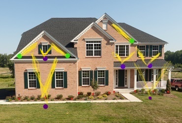

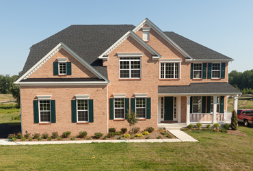

    I am looking for some advice on illuminating the second floor of my home. I have attached some pictures for reference.
    I have installed 10 Volt All-Star spot lights on the ground level with 2 watt bulbs. Their position is marked by the red dots.
    In the picture "Lighting Options" I am not sure if I should add lights at the green dots to capture the gables, but that leaves the upper right side of the house dark. Or should I put lights on the purple circles, either on gutter mounts, or further out in the yard shining up from a distance.
    The second floor is really dark. I just don't know where to begin to add some light up there.
    Thank you for any guidance you can provide.

    I certainly would not recommend installing any lighting fixtures out in the yard for the sake of lawn maintenance and the possibility of damage. Path lights along the direct edge of a driveway or path is a different story but, certainly not spotlights. A good rule of thumb is to keep ground-level spotlights or floodlights in garden beds or in the proximity of a certain feature (trees, statuary, fountains, possibly a mailbox).
    As far as the second story goes, I generally try to recommend against shining any lights directly on windows; this is for the sake of preventing light trespass into bedrooms/rooms at night and glare off of the windows on the exterior. Decorative dormers can be a different story though and some owners do angle lights directly on those types of windows or attic windows. I took the liberty of sketching out the entire layout to visually the flow. With the slight angle the photo was taken at, I'm not quite sure how much space there is in that upper eave where you only had the one light; so I was a little hesitant to recommend that light on the left side. But if there is more space than the photo suggests, it may help to complement the design on the lower eave.
    If you find it difficult to use gutter mounts in a certain situation, surface mounts have also been used. The trick here would just make sure no holes are drilled into an attic space or, its properly sealed if so.

    Would you recommend a smaller M11 bulb and fixture on the second floor eaves on the center and left side? I think the gutter mounts on the right side would be fine with the M16s I have on the ground. But the area to be illuminated on the left and center eaves is really not that big. How would the M11s compare on a small space like that?

    It could certainly work and look beautiful. An MR11 fixture would also be more discreet and you would still be able to match the output accordingly (wattage & color temperature). Because it is for subtle, accent lighting on the second story I would more than likely recommend using a 2W LED for the MR11 bulb if you did go that route.

    Would you recommend using a 2W LED in a regular All-Star or using a 2W Led in a all-Star Mini? They are both 2700K and 38 degree spreads at 150 lumens. What would the difference be between the two fixture sizes? Also, do you think I should stick with MR16s on the gutter mounts on the right side of the second floor, or match the MR11s I will use on the left and center eaves?

    Other than the difference in price and size, it is really a matter of preference in this scenario. If I was lighting my own second story, I would personally use MR11 fixtures because they are more low-profile and can have a more subtle light output (coming from someone who likes their bedrooms pitch black when they sleep :D). I would recommend MR16s for all of the spotlights on the ground except the tree maybe; if that tree will 'always' be somewhat of the smaller size as it is now, I would maybe use an MR11 on that as well. On a side note, some path lights would look great along that front walkway inside of the garden bed.
