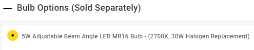

    Thanks Meso. I mistakenly typed the wrong style in my posting. The fixtures I am having trouble with are FAT BOY MINI'S, not Scotty's (sorry for the confusion!) The standard bulb Volt shows when you order a Fat Boy Mini is a 5w MR16 (see screen shot below), so I don't understand what the issue is.
    Additional Info: The issue started when I put green and red 5w MR16's in the fixtures to give the wall they are lighting a Christmas look. The bulbs wouldn't work, and after that only 3w bulbs worked.

    Hey, Craiggers. Thanks for the clarification. My feedback above remains essentially the same. For the Fatboy mini, the only options you’re presented when customizing the fixture are VOLT’s 5W ABA bulb, or 2W, 3W, 5W, or 7W bulbs and color changing bulbs. It’s possible that the single colored bulbs might be incompatible with the fixture (which could possibly explain why they aren’t presented as an option) but I think you might want to contact customer service to both confirm this and also to troubleshoot. Without knowing more about your system (transformer capacity, wiring method, etc), I don’t want to further speculate what might have caused the issue with your fixtures. HTH

    Thanks again Meso! I ordered the Fat Boy Mini's from Amazon (same product but free express shipping). No bulb is included in Amazon's Fat Boy Mini configuration, but the fixtures are shipped directly from Volt. I guess I don't understand the proprietary bulb requirement since the Amazon Fat Boy Mini product specs say: "LAMP READY - Uses LED MR16 or halogen lamps (not included) rated up to 30 watts".
    I really appreciate your help. I will take your suggestion and contact customer service.
