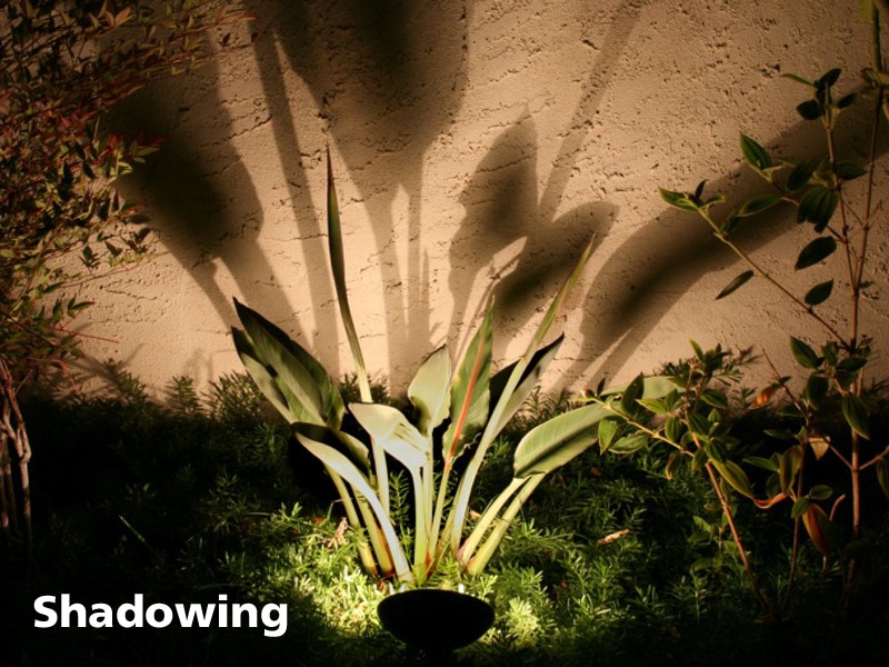

    The (6) FatBoy's could be placed at the 6 positions on the ground (marked in yellow). For the columns, you'd want to adjust the beam angle on the bulbs to the narrowest setting (20-degree). For the other spots, 60 degree will likely be ideal. Also, when installing the (3) Fat Boys on the right side, you could do one of two things:
    1. Install the spotlights within 12" of the wall to apply a "grazing" design effect to highlight the texture of the brick.
    2.Place the spotlights in front of the small shrubs to cast illumination through the shrubs creating a shadowing effect on the walls behind. Either option 1 or 2 would add a unique element to the design.
