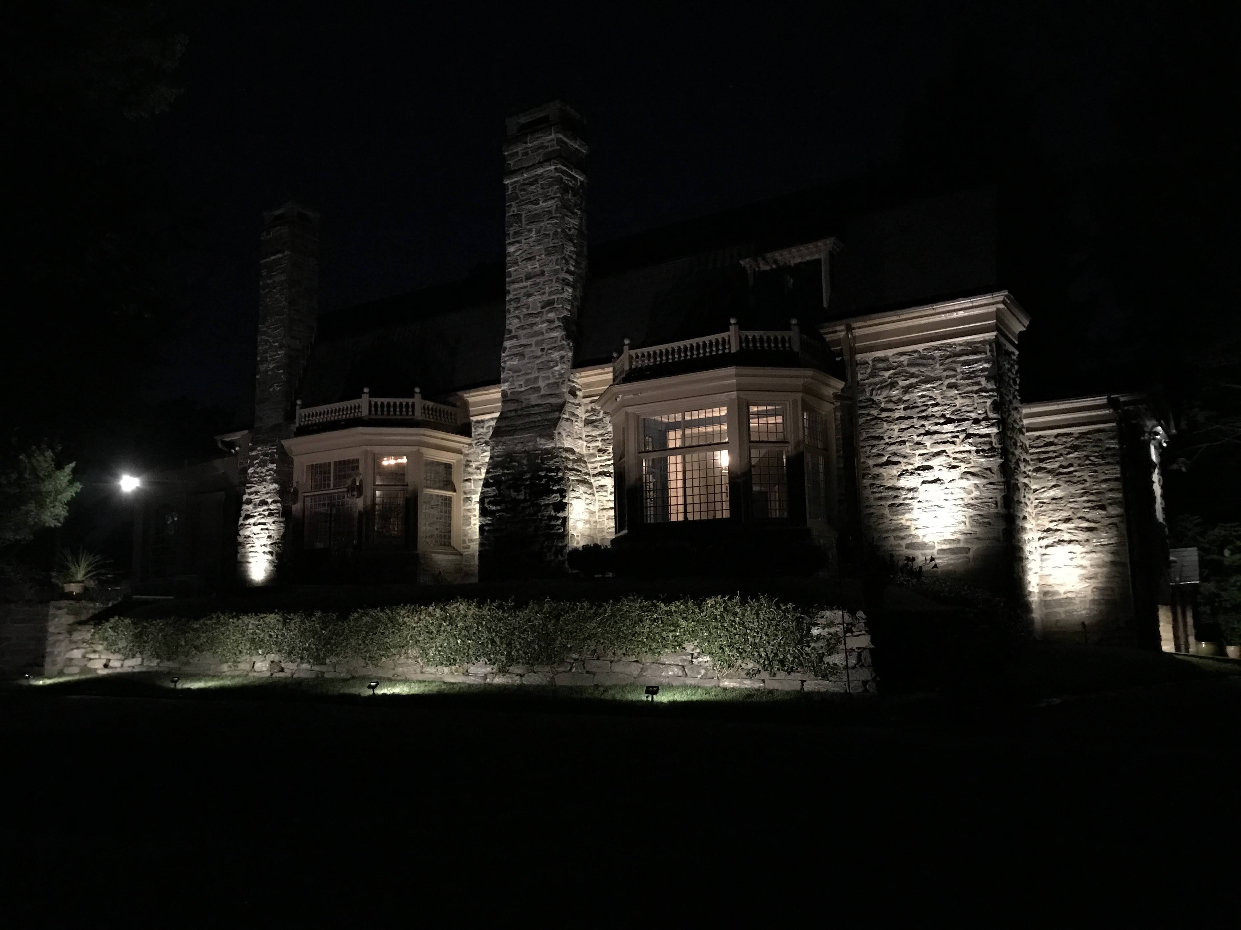

    Just want to share our lighting results! To light the stone on the house we used Fat Boys with 5W, 2700K, 38 degree bulbs (MR16). To light the lower wall we used Wide Splash flood lights with the 7W, 2700K bulbs (R7S) placed in the grass area between the sidewalk and the wall. We took your suggestion, and bought a few bulbs with varying angle widths and wattage to test what looked best. We used a 100W Slimline transformer to service 3 circuits. We're very pleased with the result and we thank you again for your very helpful comments and suggestions! IMG_5884.JPG

    You’re very welcome and this looks truly phenomenal! I especially love your vine covered lower walls. Gives your overall plan a very gothic mood. Fantastic and thanks for sharing your “recipe” as I’m sure other users will find those specifics quite helpful.
