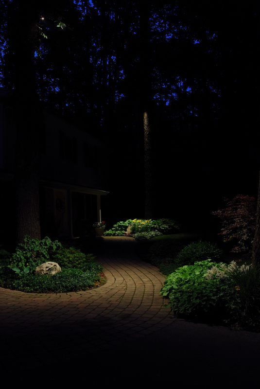

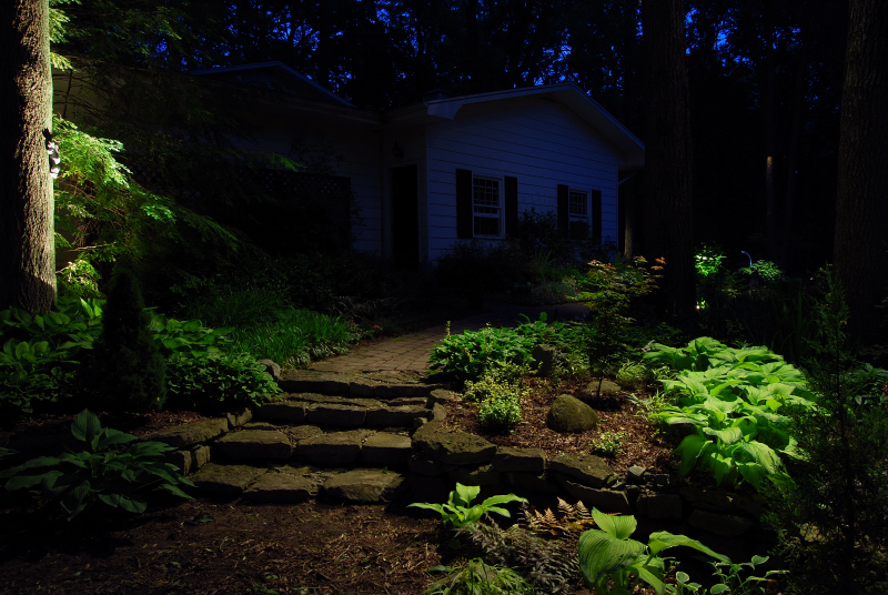

  4. Community Admin
    Here you can see an example of moonlighting: rather than a walkway, picture the creek. The moonlighting produces a beautiful, nature like illumination.
