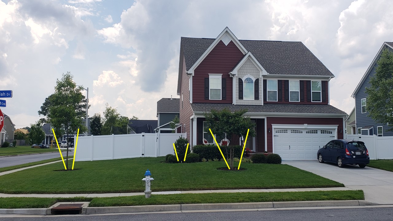

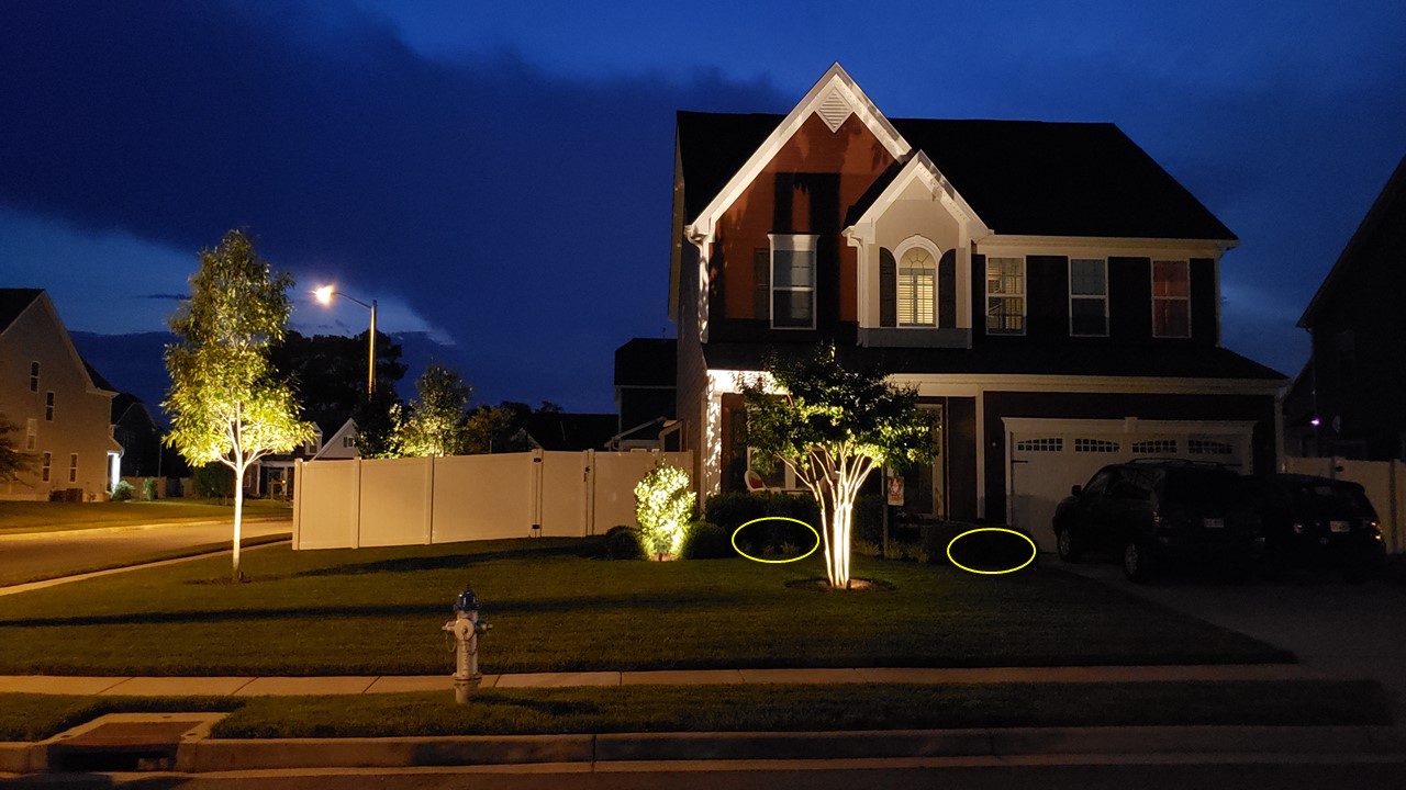

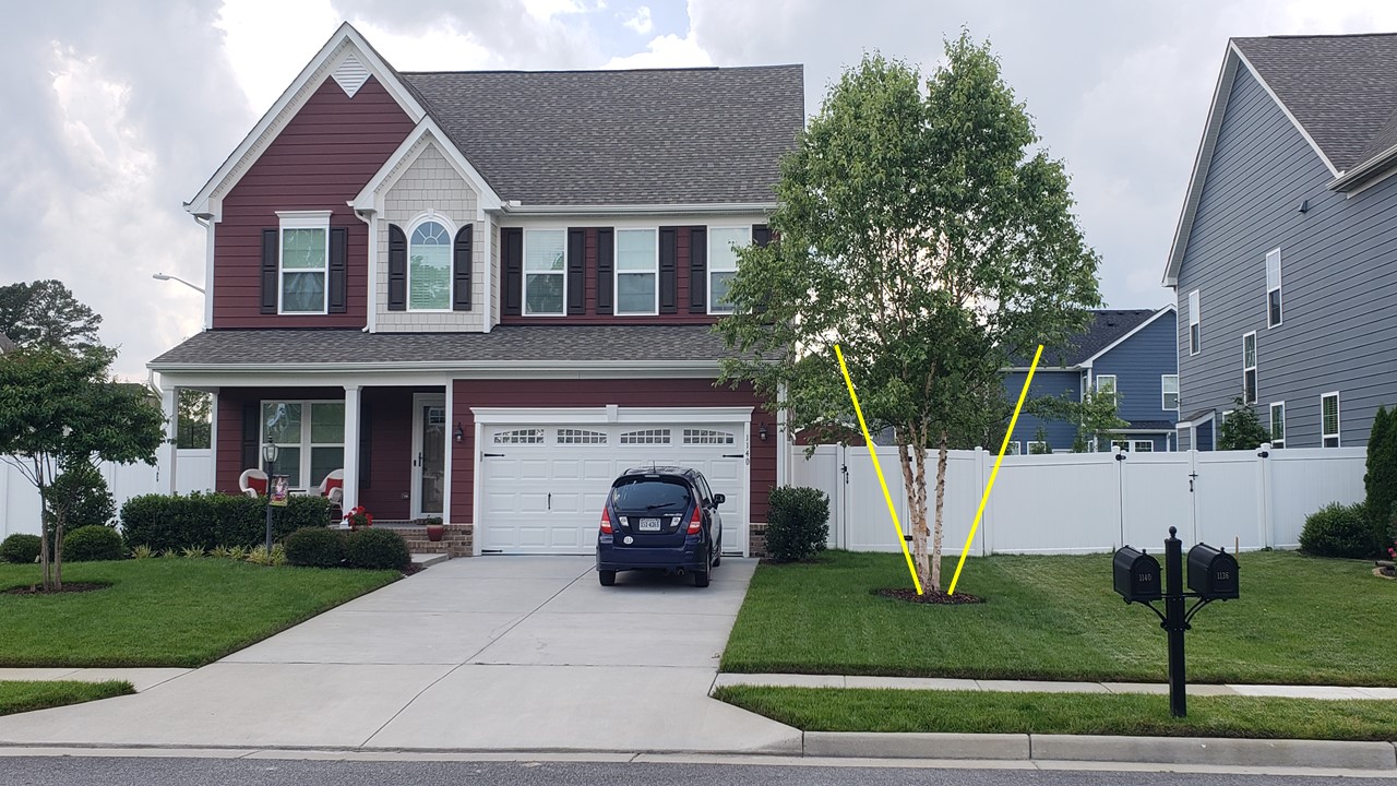

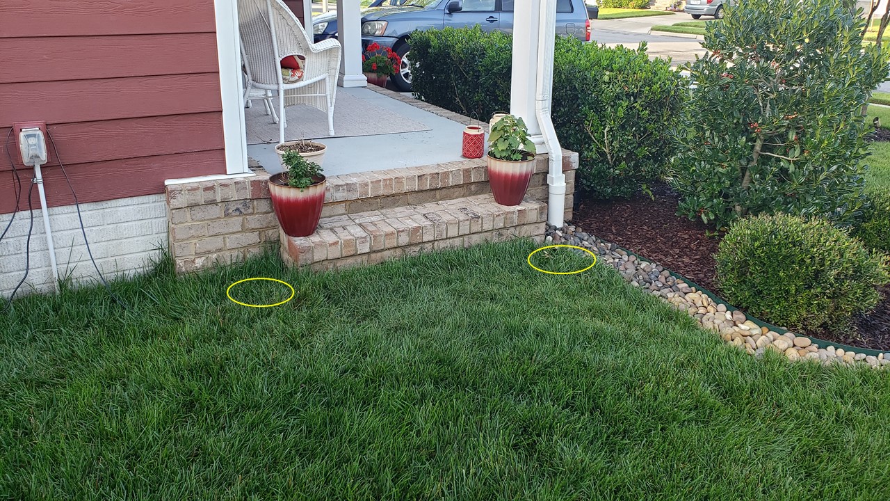

    Front Yard Day Time - The yellow arrows show where the lights are at. The one in the middle is highlighting only the tall bush and the 2 on either side. I am using a MR16 LED bulbs (5W | 38° | 2700K) right now on the light. Should I get a lower power and narrower angle?
    I have not installed a light here yet, it is in the next phase. I am going to run the cable straight to the back yard and connect to the 2nd transformer.
    At night all lit up. I am thinking about some pathway lights in the yellow circled area? Would it look good?

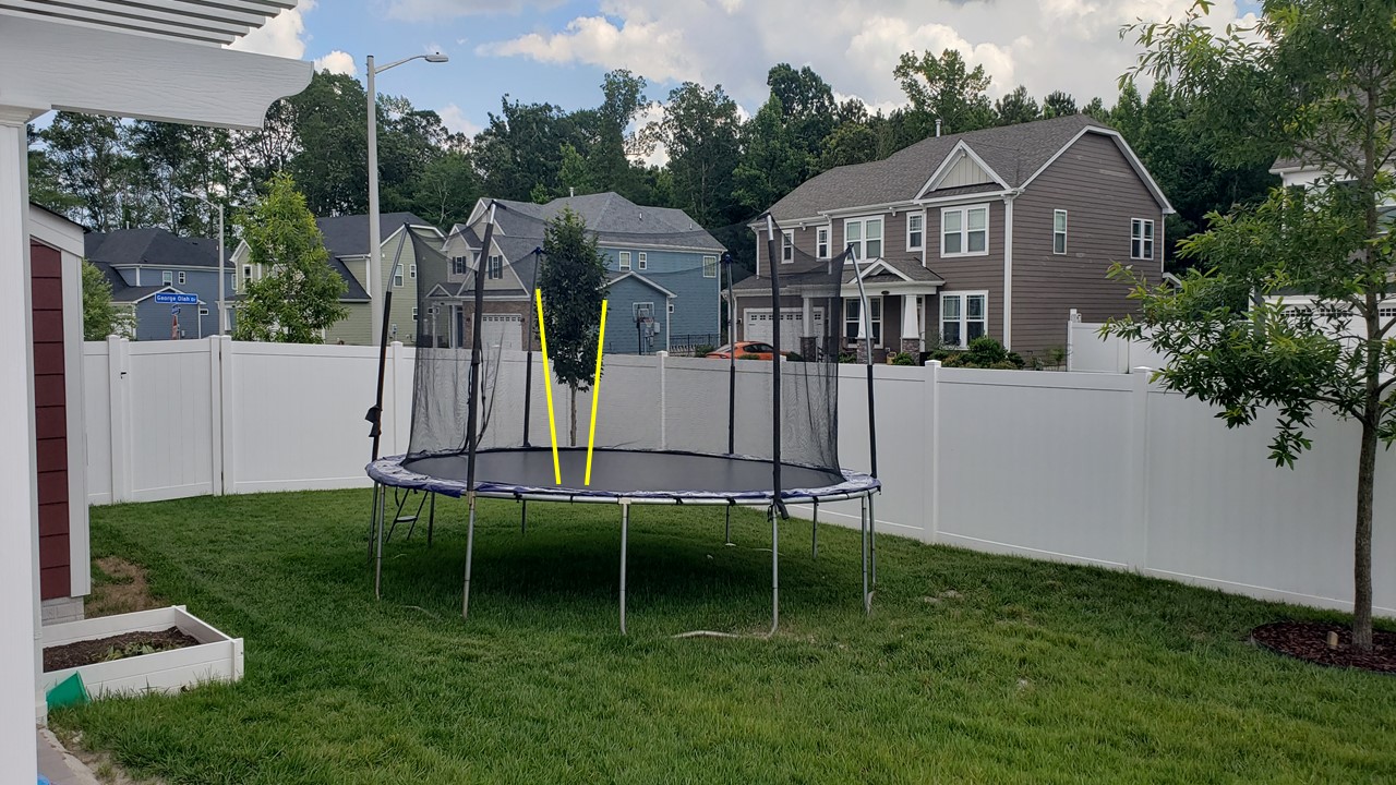

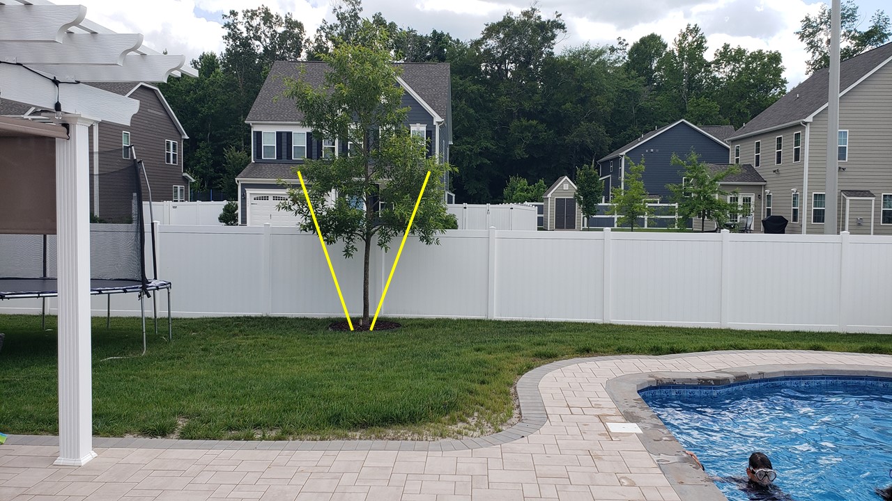

    The next 2 are showing trees in the backyard where I already have lights. Forgot to get a night shot.

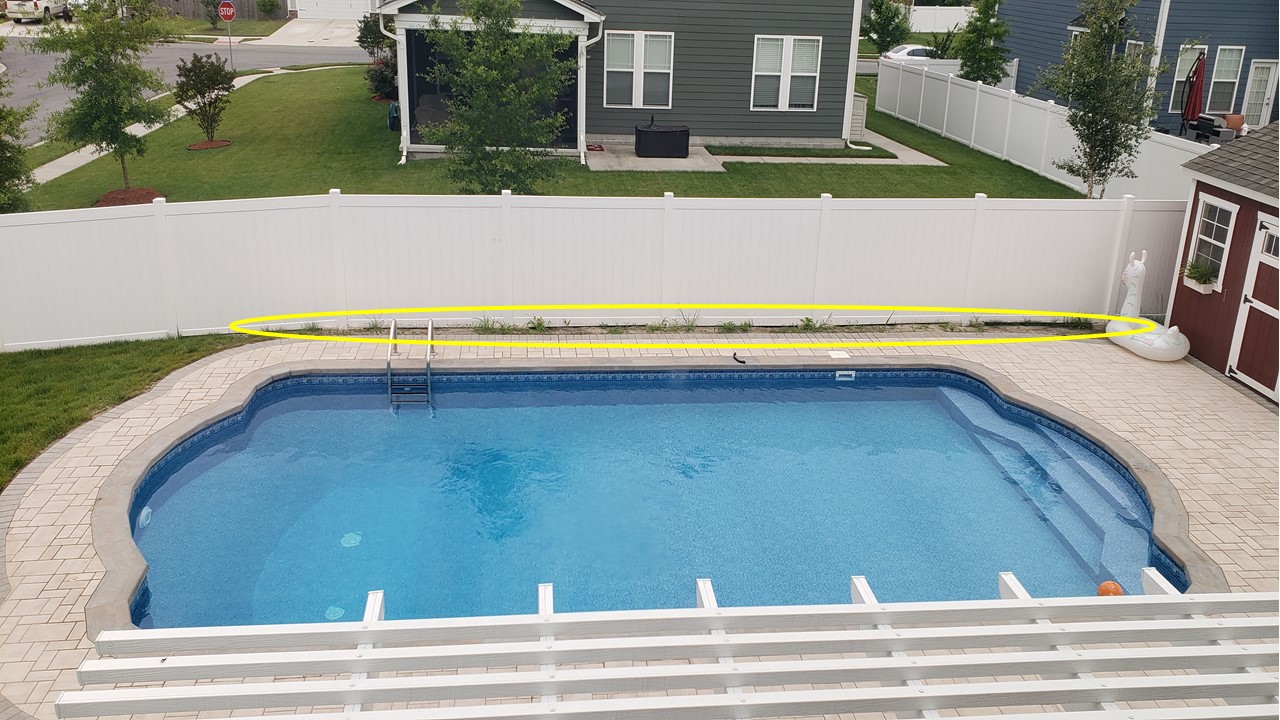

    Now here is where I am trying to put some lights at the back of the pool. There is about 2 ft from the edge of the pavers to the fence. How many path lights should I put here? 3-4 lights?
    And I am looking to illuminate the step area at night too. Just one pathway light perhaps? Eventually a path way will be put there.

    Hi, Ryan. Just some general recommendations for you. First, I think brightness is a matter of personal preference. If you're concerned that your lights are too bright, then you can always use fewer lights or tone down the ones you have with filters or lenses. It looks like many of your trees and shrubs are fairly young. It seems to me in cases where you're using two 38° spots, a single 60° might work just as well. I'm something of a minimalist myself so I'm biased. Often the only way to know what will work best is experimenting with different beam spreads and light lumens. As for the side of your pool, I'd be concerned that lights on that narrow strip of ground would get easily damaged or become a trip hazard. My preference would be to mount downlight or other lights with a good glare shield on the fence itself. If that is not an option, I'd install a few of the lowest profile path/area lights (see below) in that narrow strip and hope for the best. I get the impression that you've discovered that a little light goes a long way. My advice to you would be to first consider how much of an area you want to light and then choose a fixture you like that provides the coverage you need. There are path lights that produce a 16' diameter pool of light and some that produce a 5' diameter pool of light and everything in between. I also strongly encourage you to look at the lighting gallery images (there's at least one poolside lighting project) and more path lights that might suit your needs. Hope this helps.

    For the strip of land by the pool, Here is a better image.
    Thanks for the advice.

    Glad to help. Thanks for the photo. Again, if you place path lights in that strip, I’d recommend fixtures with smaller overall footprint. One other thing I may have forgotten to mention is that except for the submersible models, fixtures are water tight but they aren’t indestructible. IOW just as you would want a sprinkler shooting water up underneath most path light canopies, buckets of pool water routinely splashing up inside fixtures is probably not a great idea. Just FYI.
