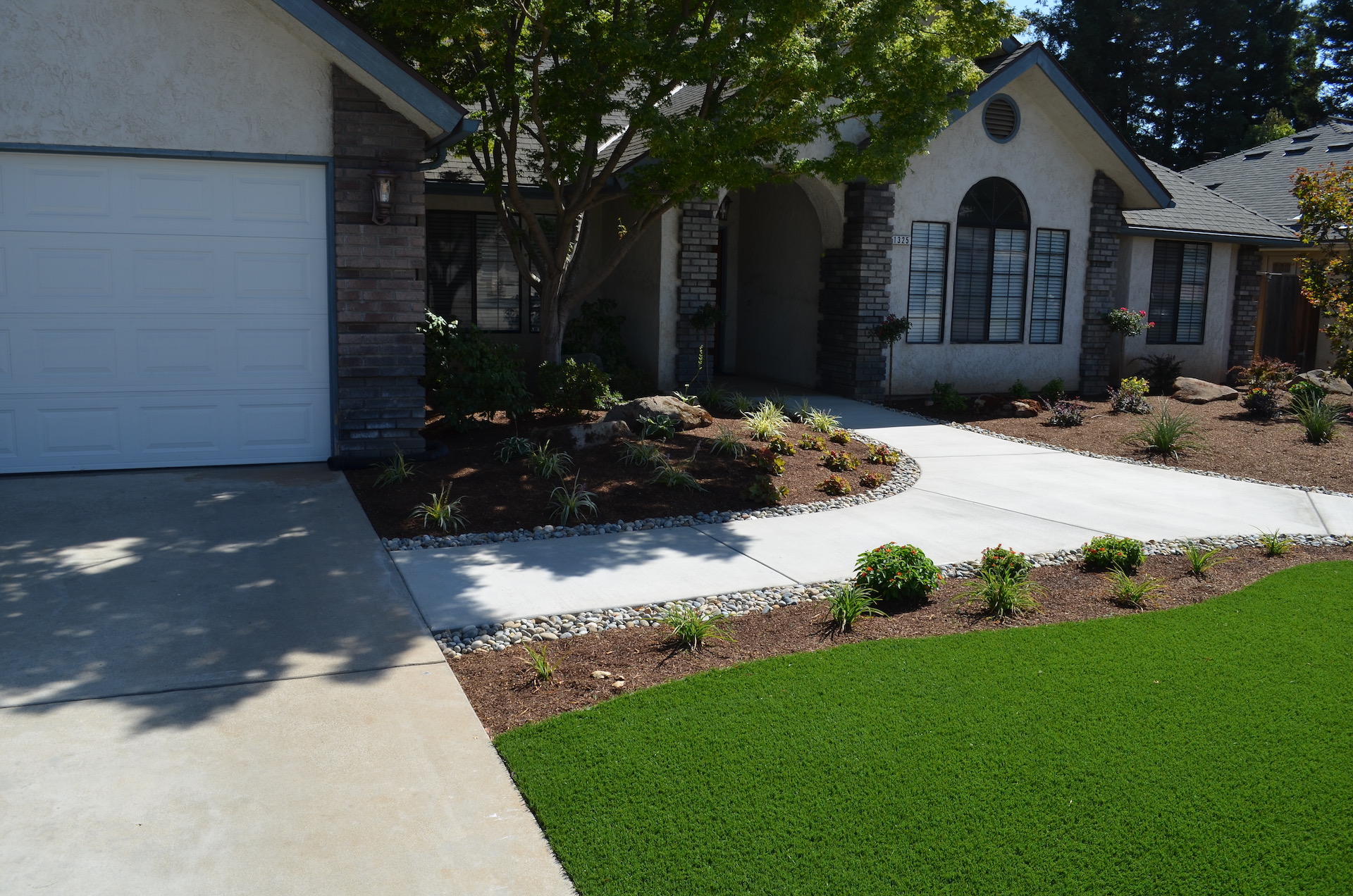

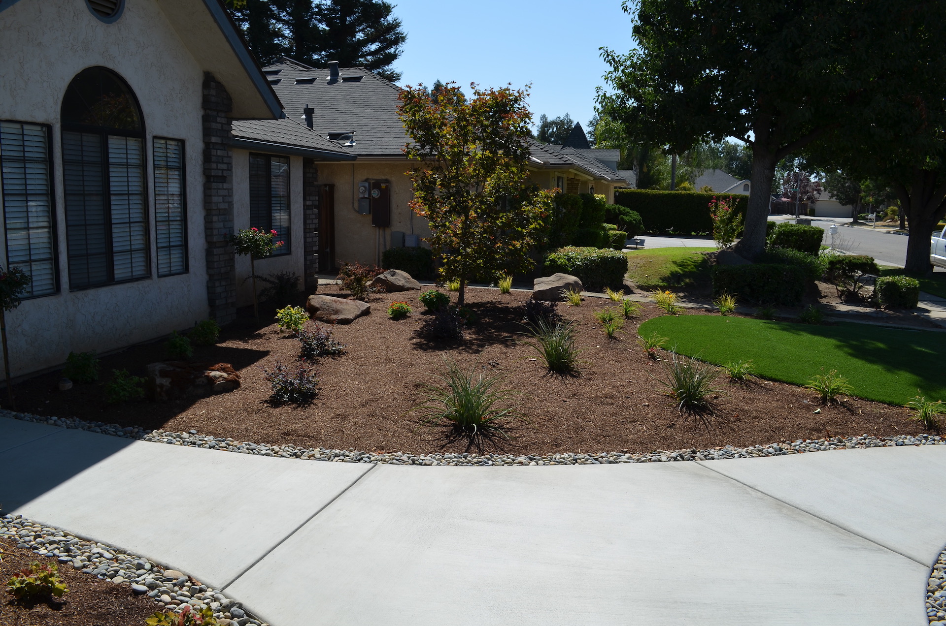

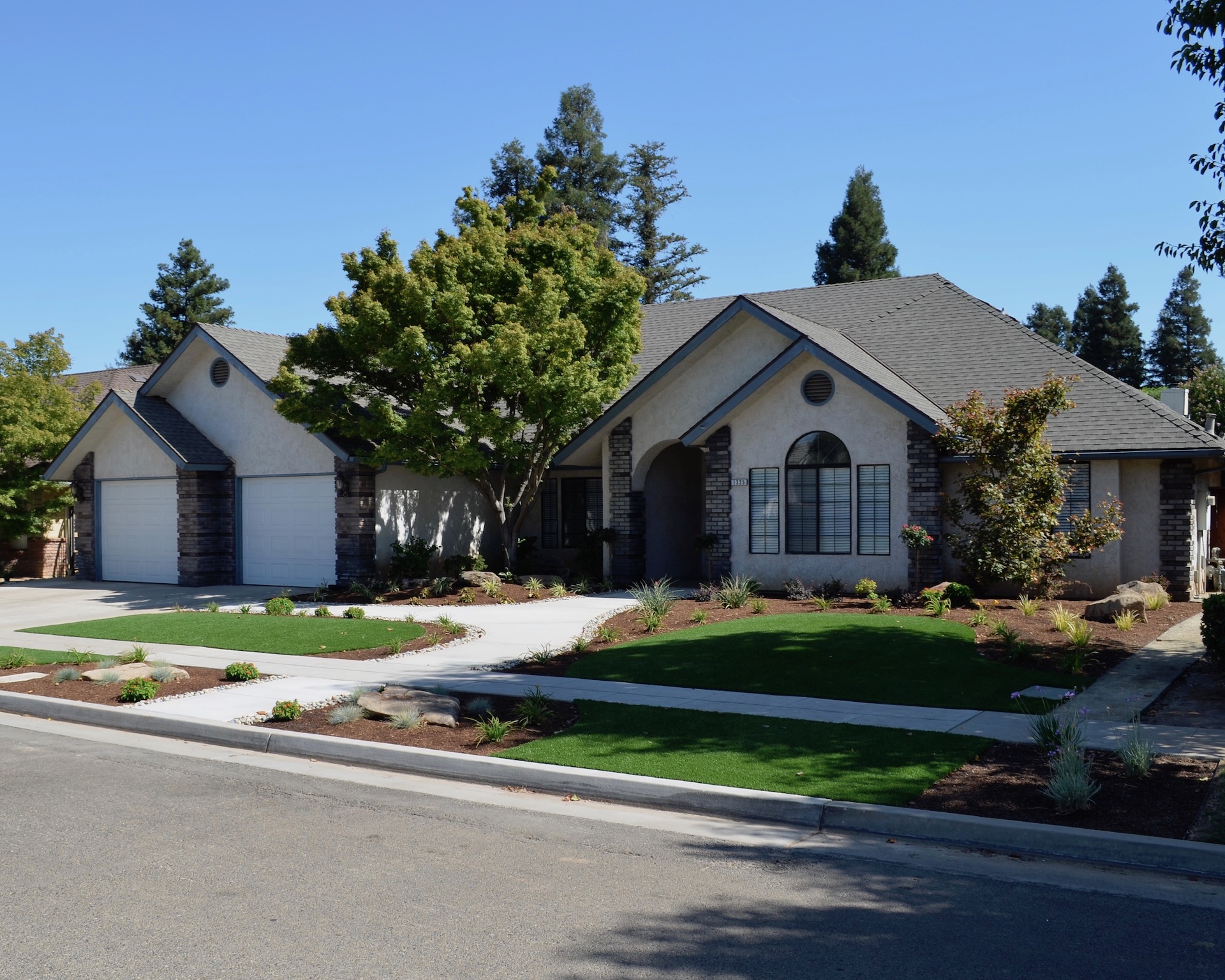

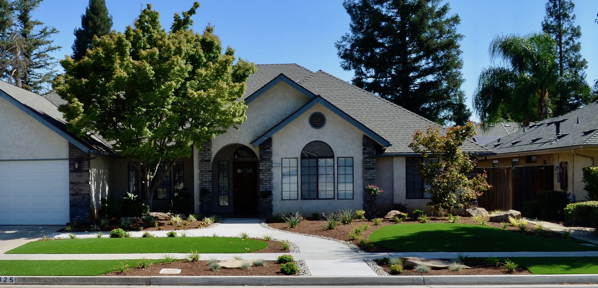

    We recently re-landscaped the front yard and I am looking for some lighting recommendations. We would like to highlight the large and small Japanese Maples and also provide some lighting along the walkway and in the plant areas. Any advice and fixture recommendations would be appreciated. Thanks.

    What a beautiful home and garden (I especially love the boulders)! Using one of your photos, I highlighted the trees I think you’re planning to light. I also placed yellow ovals to indicate possible places for your path lights. I think any of the spotlights (All Star, Top Dog, Fat Boy) would be great for your trees. If you want to go really low profile, you could opt for one of the well (or in-ground) lights. Because we have landscapers and the mailman likes to sometimes take shortcuts through our front yard, I chose to put in-ground lights in areas where spotlights might get damaged.
    To decide the best places for path lights and which models would work best, you’ll want to consider the effect you want as well as what the existing lighting is like at night. Do your your porch or garage lights stay on all night? Are there streetlights in front of your house that might wash out the effects of some path lights? These are just a couple of factors to consider when deciding where to place fixtures, which type to use, and how many path lights you’ll need. Ultimately it’s a matter of your personal preference but I think it’s a good idea to place path lights where there is some change in grade (a step or curb), a curve in the pathway, or some other transition. If you want individual pools of light that are primarily focused on the path, you’ll opt for some of the smaller hat fixtures that are lower to the ground and/or with a smaller beam spread. If your goal is to both light your path and highlight certain landscape features, a higher profile fixture like the Max Spread will give you the most bang for your buck. Hope this helps

    Thanks for the replies Mesodude and Evan! I wasn't sure whether one uplight would take of the large Japanese Maple. Also, would the Path Light nearest the windows provide enough light to highlight the surrounding shrubs?

    It really depends on the effect you were going for. Typically, 2 or more fixtures would be recommended for trees with large diameters (such as oaks), or for trees that act as centerpieces in a garden/property. Rather than just tossing in a single powerful uplight (likely 120V line-voltage for larger trees), the goal on a tree is generally to cover all of the important viewing angles and simultaneously give a 3D effect per se. With your tree, a 7W LED MR16 in any one of the lamp-ready fixtures that @Mesodude mentioned would look good; to really make that canopy pop you could consider using (2) fixtures either with 5W bulbs or 3W bulbs. You could place them in a perimeter around the tree or, some designers and homeowners place one aiming up the trunk and another placed slightly further back from the trunk directed up towards the canopy.
    For path lights, the diameter of the light output would be dependent on the style of hat you chose for your stems. Our Max Spread Path & Area Light for example is our most popular classic style and has a 16' diameter spread. A good spot for another path could be just in front of that boulder to the right of the front window to help continue the flow of light in that larger garden. The most common bulb for these lights is a 3W LED with a 2700k color temperature. Wattages can vary across different fixtures/different areas of your yard but you generally want to keep the color temperature the same for the design.
