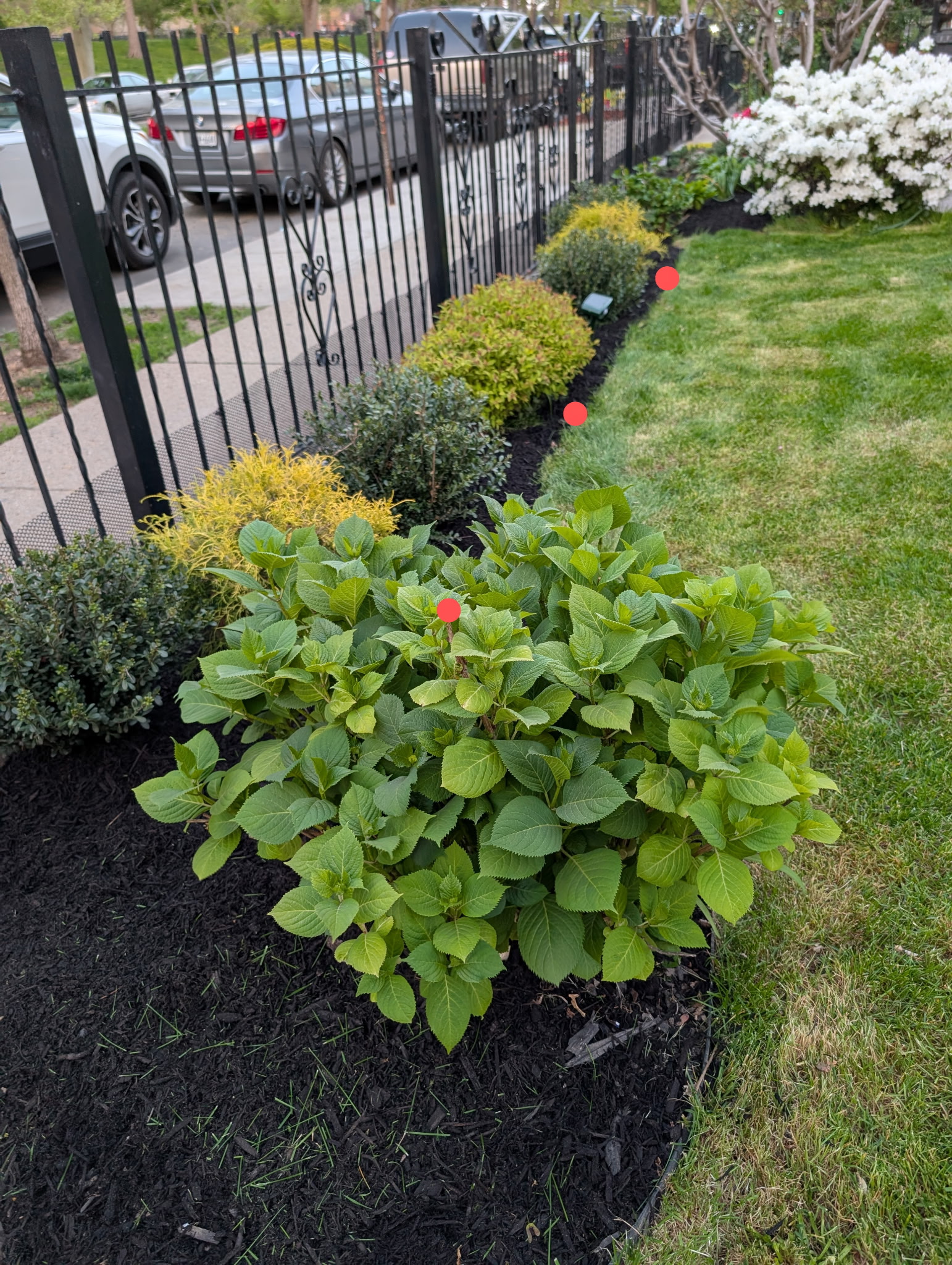

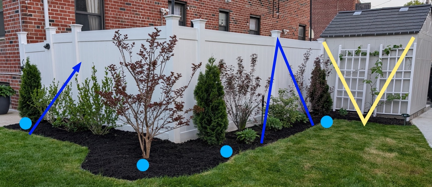

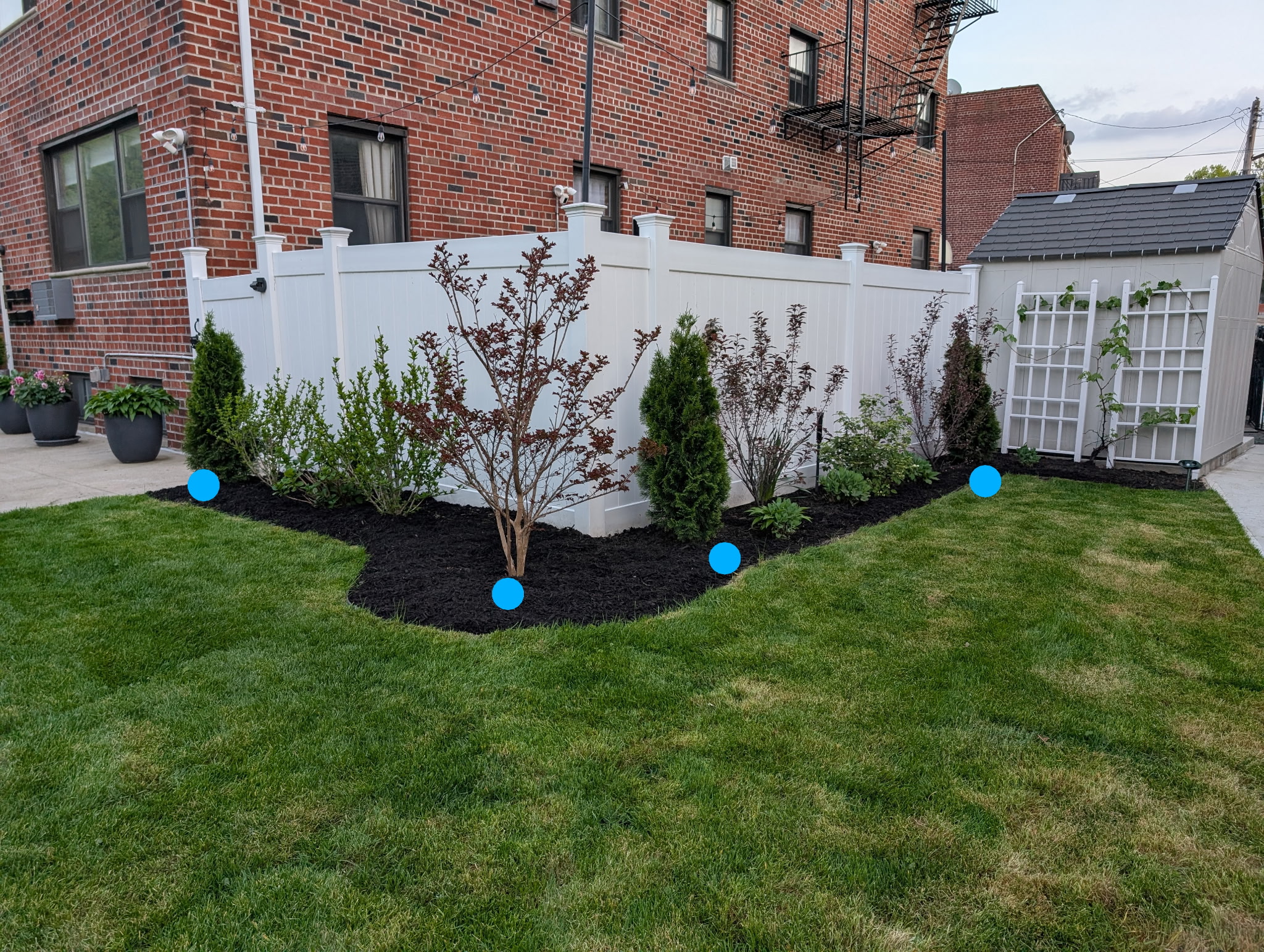

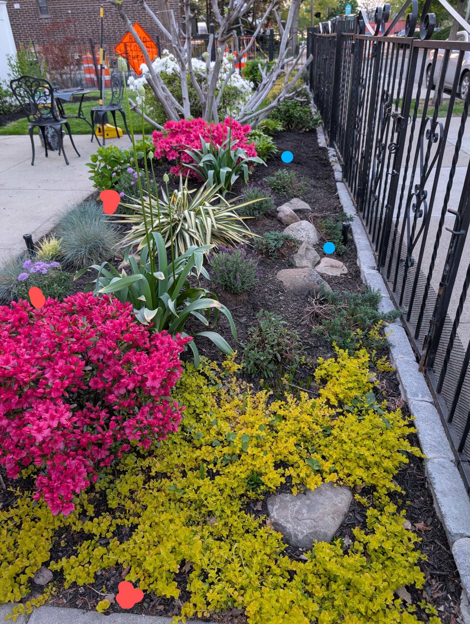

Hi guys, I'm thinking of putting 6 spotlights and 6 pathway lights in my front garden. The blue indicators are the spotlights and the red are for the pathway lights. What type of pathway light should I get? Max spread? And regarding the spotlights - what is best for me? Fat boy or Top dog? Small, medium or large? I am getting a 150w transformer in order to potentially add more lights down the line and 14/2 wire + pro junction connector. Your help would be greatly appreciated. It's difficult to get this done on my own and I would love any advice from people here. Thank you!
