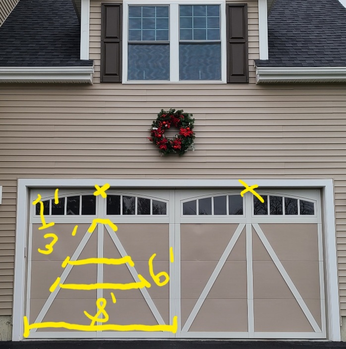

    Thank you. I did check those videos out just now. Just trying to figure out if a 12" or 18" hardscape light is for me. I'm illuminating a garage door that's about 8 feet wide and about 8 feet tall.

    Hi, Beantown. Without seeing a photo, I'm not sure you'll find my feedback very meaningful. I will say that what you really need to ask yourself is how much light is sufficient to achieve the results you have in mind. If you're talking about using a single fixture above the door, understand that there's not a huge difference in light output between the 12" and the 18" hardscape light. And if other nearby lights (like the wall sconces that typically flank a garage door) will be part of your plan, the difference is likely to be negligible, IMO. Something else to bear in mind is that most (if not all) of the lights shown in the gallery are the higher profile "undercover" hardscape lights. The there are much higher lumens lamps available for these than the brightest of the low profile rotatable hardscape lights you're considering. I only point this out because I don't know what homework you've done already and if you like what you're seeing in the gallery pics, the fixtures you have in mind might not be be bright enough. Now, aren't you glad you asked me? ;)

    As a matter of fact i am! You are super helpful on this forum. Sorry I'll attach a picture.
    You see, I was thinking to mount Volt's 12" or 18" hardscape light where the "x" marks are tucked away under the frame. I thought this would he cool because the designs on the garage door seem to mimic a downward beam of light. What do you think?
    18" fixture was my first choice but then the specs said both the 12 and 18" fixtures have a 120° beam spread. I thought the hardscape lights illuminated straight down from its one end of light to the other. If this is still the case I'll stay with the 18" but the 120° beam spread metric is fooling with me.
    Basically I just want a hardscape fixture that will illuminate the garage door (doesn't have to be all the way from top to bottom, nor do I think the hardscape lights can do that. And the other criteria I have is I don't want to get a fixture so wide that each fixture's light trespasses into the other section. Each light illumination spread stays within its section.
    Pretty sure 18" will still work but if not I'll go 12" just looking to get the opinion of folks who are more informed than me on here.
    Thanks as always for any help!

    Glad to help. Your pic and a more detailed explanation of your goal are both very helpful. I'm wondering if a puck light might be a better choice for the effect you want to create. I'm attaching a few photos to illustrate why I feel that way. I mean it seems like depending on a linear hardscape light's width and the angle it's aimed you could create that conical or triangular shaped beam but I think because they more closely mimic a flashlight's beam, a puck light or spotlight beam will create the effect more precisely than the beam that's created by the linear hardscape fixtures. But if Evan or others don't chime in, it might be worth contacting customer service directly. They'll be able to tell you with more authority what effect each light fixture type can best create the effect you have in mind.

    Once again a great help! I really like the puck lights in the green garage picture. You're right the beam does mimic the downward design of my garage doors. It seems the middle 2 stone pictures are the 12 or 18" hardscape fixtures i was curious to see in action also? Those look great too. But can't deny the puck lights may be a better fit for me. When the puck light bulb dies it looks like I have to buy a whole new puck light, correct?

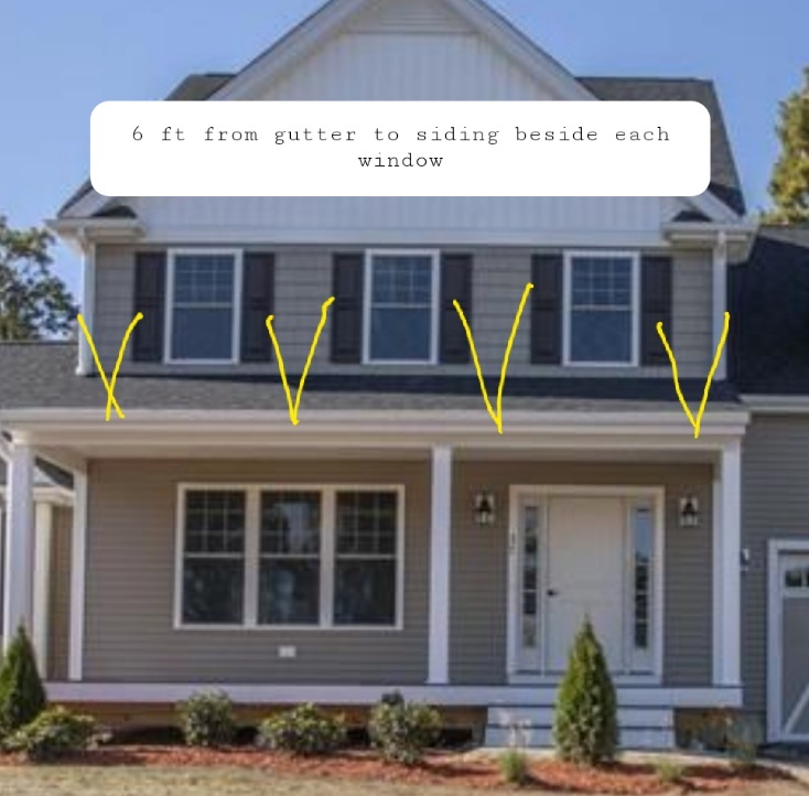

    Any ideas on the wattage of bulb to use if I'm gutter mounting spot lights on the second level as shown below. There's a 6 foot distance that the light has to travel to get from the gutter to the siding beside each window. I'm thinking these lights should be 5w or greater because of the 6 foot distance. 20210115_165002.jpg

    Hard to say. If you know what brightness level you want for your columns and the puck lights, you can use that as your guide for choosing your gutter fixtures. Choose a lamp brightness for the gutter light that you think best compensates for that distance. If you're really struggling with the decision making, you can always get a second opinion from a VOLT rep.
