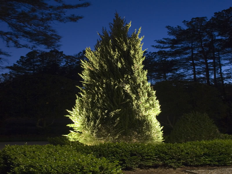

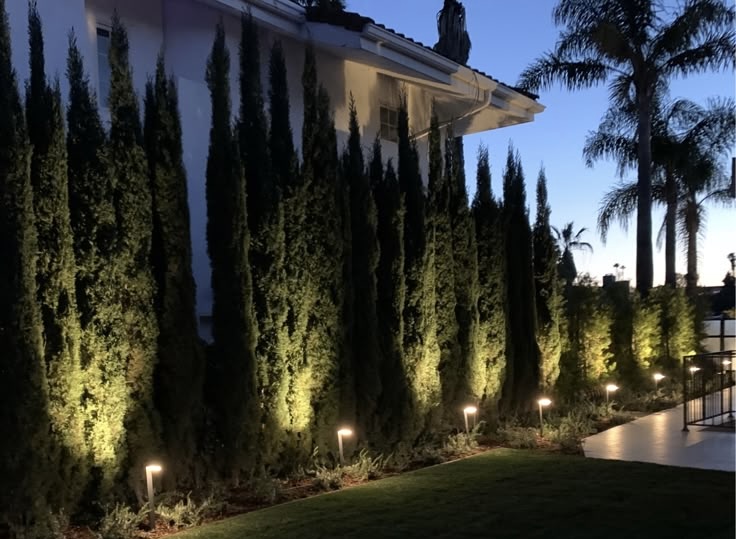

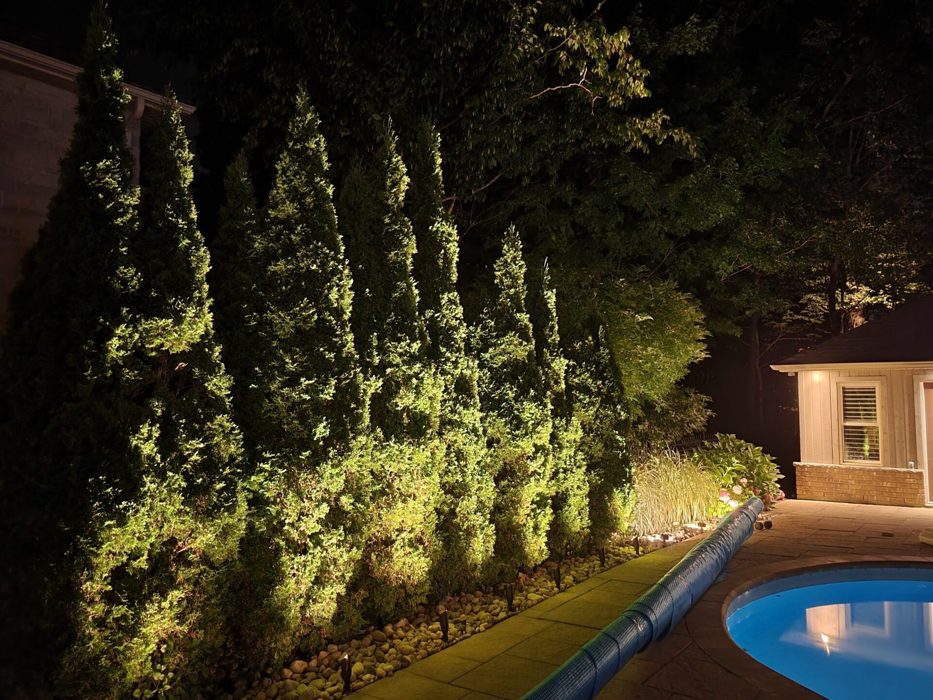

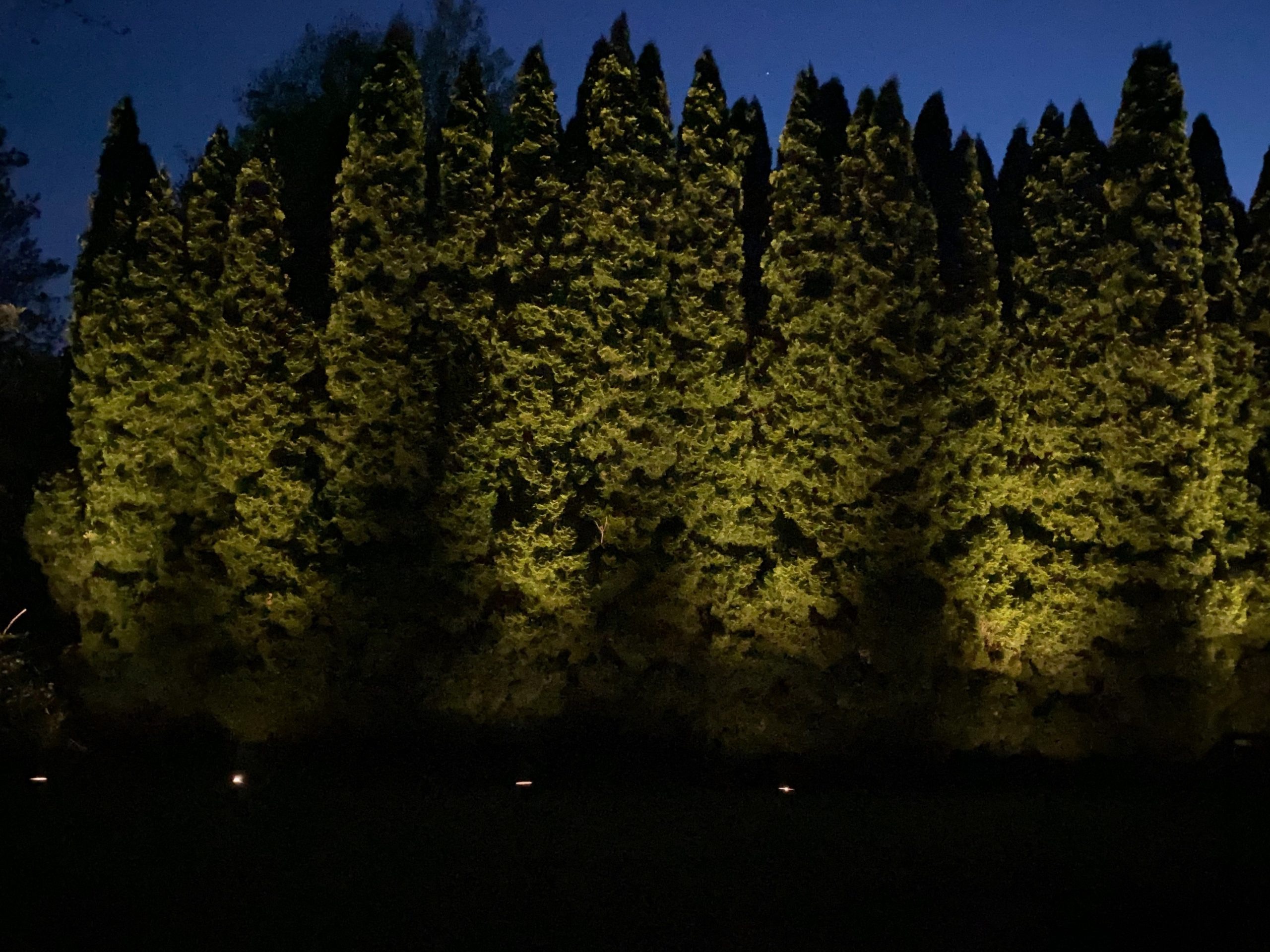

    I’m a fellow DIYer but I’ll try to tackle some of your questions. First, AMP is for professional landscape lighting installers and VOLT is more consumer oriented. I believe the products are the same but just under different name badges. If you wanted to hire a contractor to install your lighting, that contractor would probably purchase AMP labeled products on your behalf. As far as fixture numbers, there is no one single best approach to creating a landscape lighting plan. It’s really a subjective thing.
    As you can see in the examples I’ve posted, some people choose to accent a tree so that it’s partially illuminated from the front. Others may choose to flank a tree with spotlights. And others might choose to light a tree in a more three dimensional way so that it can be viewed from multiple sides. Depending on how much light you want to introduce to a given area of your property, you could go with lamp fixtures in the 1W to 3W range for very subtle lighting or if you wanted to make a bolder statement, you might choose to go with lamps upwards of 3W. A good landscape lighting specialist can help you zero in on the statement you want to make with your lighting or they can recommend lighting levels if you have a specific goal like security in mind.

    1) Do you think the lights I have placed in general seem reasonable or far too few or too many?
    2) That makes sense on the spot and floods over well lights. Do you have any recommendations for which ones where? I assume I would want the floods on the privacy trees and the spotlights on the house but I have no idea really. I think less is more on the lighting and defiantly like the lighting in the 3rd photo the best.

    If your goal is to illuminate all of the shrubbery in those areas, I think you have about the right number of fixtures. BUT…this is where having a talented landscape lighting consultant or specialist might be able to provide you more meaningful feedback than I could from just looking at your photos. If I were advising you, I’d want to walk the property with to discuss your budget, what your goals are, what you do and don’t want, what’s realistic or probably not a good idea, etc. For instance, your path lights. I could also look at how tall various trees and shrubs are to determine which fixtures would work best or which ones wouldn’t work at all. On your drawing, looks like you’ve got eight of them near the steps. But if you use path lights with the widest beam spread, you could possibly light the steps with just a few and use additional path lights elsewhere. Another way you could illuminate your steps is by either using more fixtures or slightly brighter lamps than you use elsewhere in your lighting plan to illuminate the group of trees/shrubs marked in purple below. In fact, I encourage you to vary your fixture brightness for different areas you’re lighting for both practical reasons like the one I just mentioned but also to add depth and complexity to your overall plan. In the lower left corner of the bottom photo, I show you how you can choose path lights of differing beam spreads to highlight as much or as little of your path and nearby plants as you want. It sounds like you’re planning to uplight or front light (possibly with flood lights) many of the shrubs around the foundation of your home. For some variety, maybe you could illuminate that wall behind the group of shrubs near the greenhouse (see photo) or illuminate the wooden siding behind the plants in that narrow island bordering your walk way. Btw, if you are planning to illuminate your house as well, that is another variable that might influence the approach your lighting planner uses for lighting those different areas of trees and shrubs.
    For your spot light fixtures for the taller trees and shrubs, I would recommend the Top Dog Scotty full size fixture. IMO, it’s the most versatile and the most customizable. In certain circumstances, depending on your lamp beam spreads and how you adjust the fixture, you could even use the Top Dog Scotty in place of a flood light. For your flood light, I would go with the Gentle Splash. It’s just an all around great flood light fixture that can be used in a variety of situations. Unless you’re planning for dozens and dozens of fixtures, or for very long runs (like over 150 feet), I think a couple of the 300W fixtures should be enough for what you’re planning and still offer sufficient capacity should you later add more lights. If you’re like me and you want to be able to choose from different timer, photocell, and wiring options, I would go for the chunkier models over the Slim Line models. The slim lines are great but the thicker bodied transformers will allow you to use an astronomical timer and they’re also more smart plug friendly, IMO. For your wiring, 12 or 10 gauge should be more than adequate for your needs.
