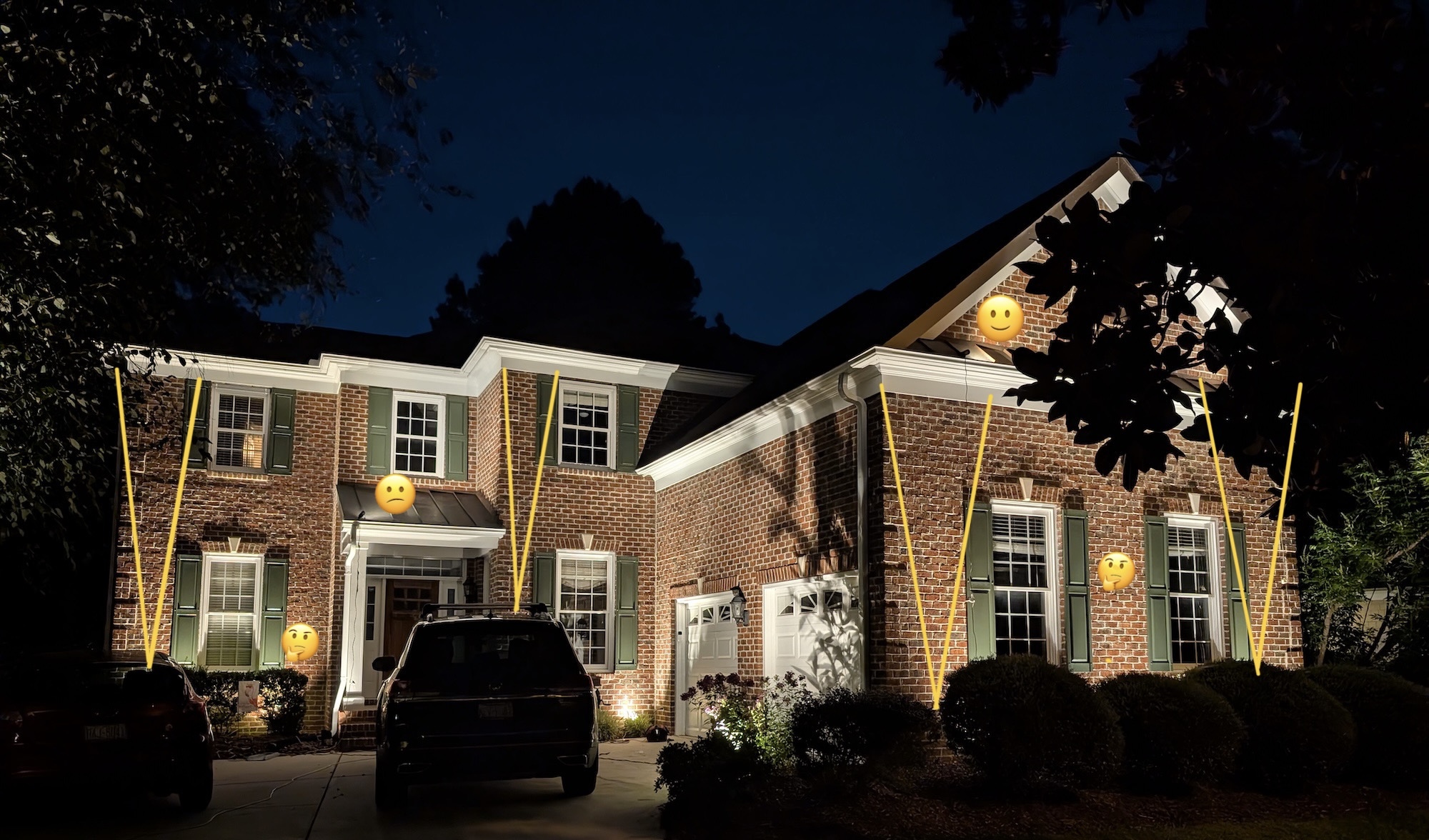

    I plan to have 8 spotlights pointing up to brick walls (up to 20' high) installed in flower beds about 1 foot from the wall, 1 pointing up to a birch tree, 1 to a brick wall but installed in the gutter or wall above the front porch, and 1 pointing up to a white column in the front porch. See the picture for what it would look like (except for 2 extra ones in the gutters above the very first 3 front windows - right side - that I don't plan to install since it would be hard).
    1) which angle should I use for the brick walls? I was thinking around 38.
    2) would it be okay to use ~38 degree angle for the birch, front column, and above-the-front-porch too?
    3) planning to using MR11 spotlights (maybe ~2W) since I cannot use them too bright due to HOA restrictions. is that okay?
    4) how should I run and hide the wire that will go up in the front porch for the fixture to be attached closer to the gutter?
    5) I'm planning to use spotlights for all of them to keep it simple. is that fine?
    721
    291

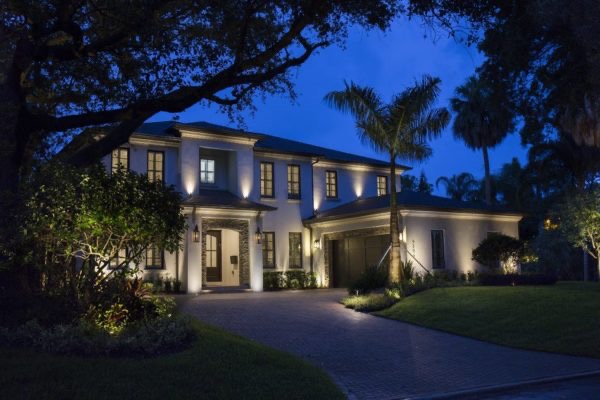

    Hi there. Fellow landscape lighting fan here. I diagrammed your photo to suggest an alternative approach to uplighting the facade of your home. Feel free to take my recommendations with a grain of salt. A more minimalist approach (one that’s less likely to be vetoed by a HOA, imo) would be to highlight only the sections with the quoins (where the yellow graphics are) and the gable on your garage. 38° seems like it could be a wee bit wide for the wall sections. They’d probably be just fine for the gable. Not super excited over the idea of lighting that area above your portico with the offset window. First, there will probably be sufficient spillover light to illuminate that area (from from the lighting on the section to the right of your portico) but also, light intrusion might be an issue if there’s a bedroom or sitting area there. If that’s not an issue for you or you’re concerned that section will be too dark, by all means, go for it. I included the photo of the other house to show you what highlighting those sections with narrower beam spreads would look like. If you decide to illuminate the gable and/or the area above your portico, the easiest and least intrusive approach (imo) would be to gutter mount your lights by running wire up through your downspouts. HTH

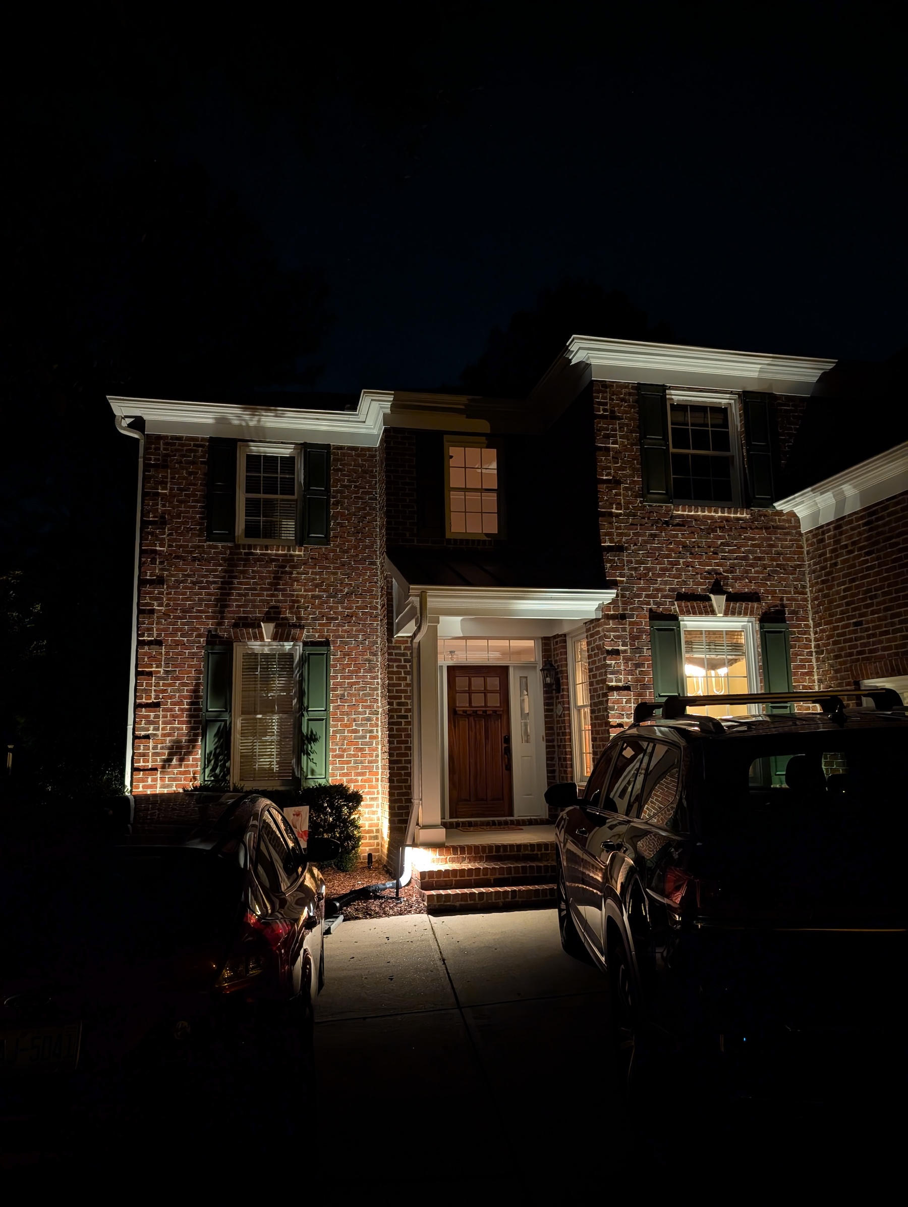

    2. The area above the front porch gets too dark when the other areas are lit. I attached a picture to illustrate that. Since that window is only for a closet, I'm fine with some light intrusion. Do you think I should use a 60 degree for that one above the front porch?

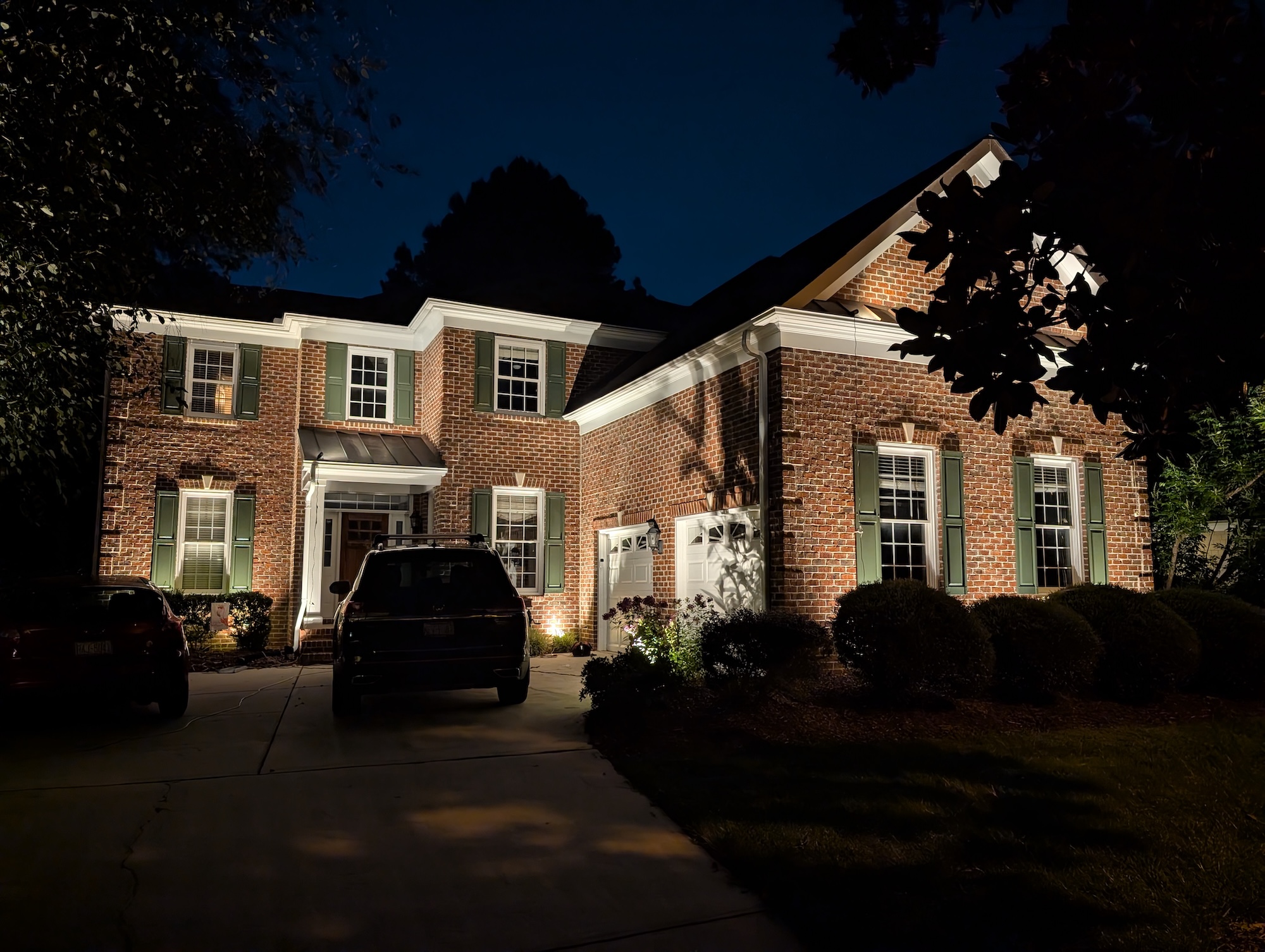

    Here's the almost-end result. I haven't placed the light attached to the gutter on the front porch. I may not do that just because it's gonna be a bit of work, it may lead to too much light intrusion, and I already like the result.
    I ended up going with 11 top dog medium MR11 spotlights. I wanted something a bit more affordable. Got the fixtures from Volt and the LED lights, junction hubs, wire, ... from Amazon. Thank you for the help!
    721
    291
    Very nice job and glad to hear you’re happy with what you’ve already accomplished. I’ll bet you weren’t planning to have the shadows from your shrubbery there projected onto your garage door like that but what a striking effect, huh?:) Little surprises like that are one of my favorite parts about landscape lighting projects.
