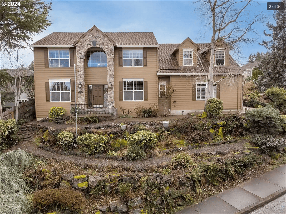

    Hello!

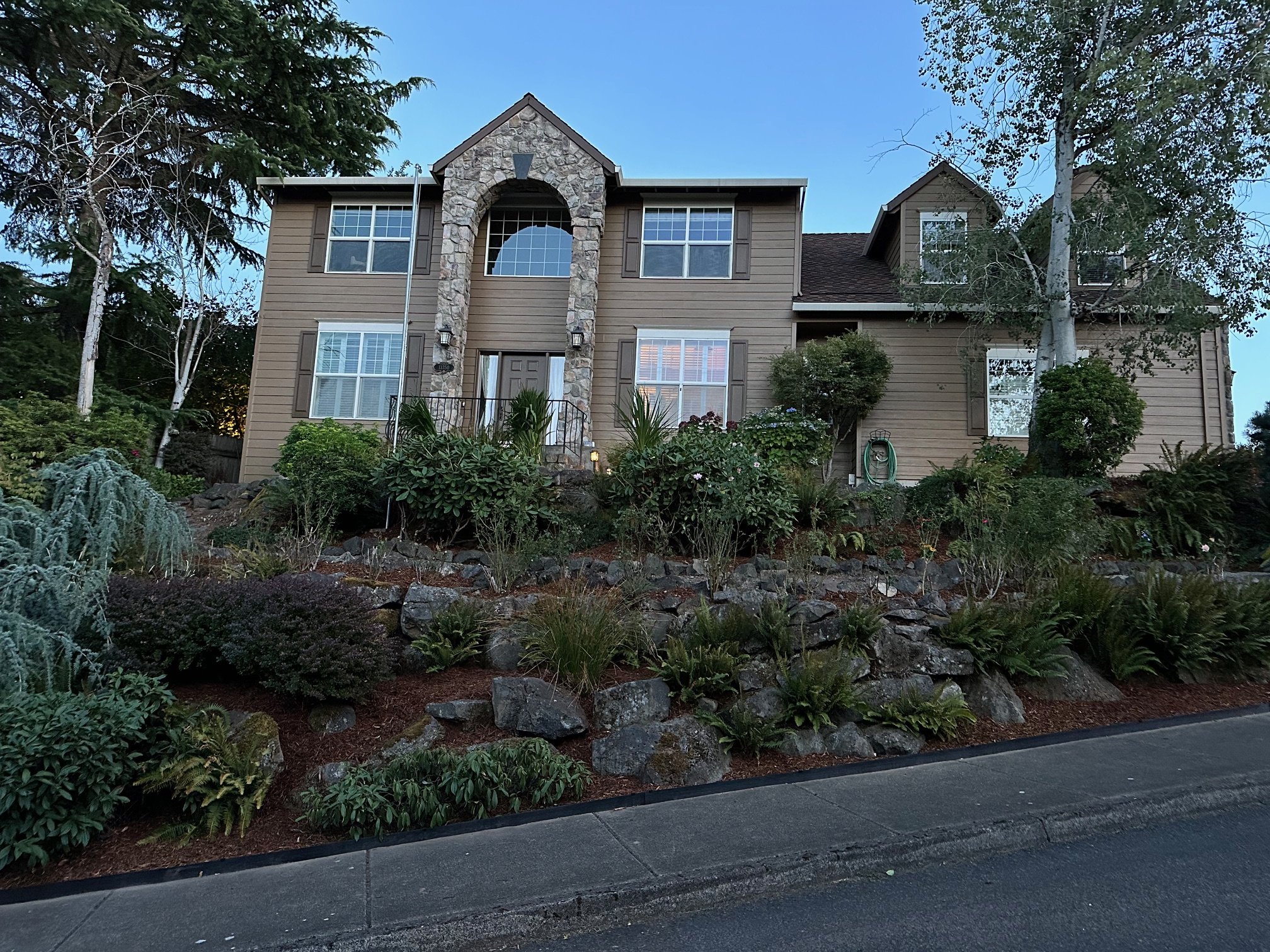

    I'm trying to come up with a landscape lighting design for our house which has a uniquely terraced front yard. We are hoping to utilize RGBW lights to give us flexibility to decorate around the holidays. I'm having trouble envisioning how to go about lighting a yard like this to show off the depth/complexity without over-doing it. We have solar path lights along the entrance path from the door off to the right, but these are easy to envision. I'm more stuck on how to light the rest of the yard and/or house with some combination of uplights, downlights, flood lights, or others. Any advice would be very appreciated!
    Couple of notes:
    1) The photos are from prior to purchasing the home, and were taken in the dead of winter (so the foliage is all gone from the trees.)
    2) The gravel path through the middle of the yard doesn't access anything except the flower beds/terrace levels, and doesn't need to be lit.
    3) The flag pole in the middle-left of the yard is being removed-- no need to light this.

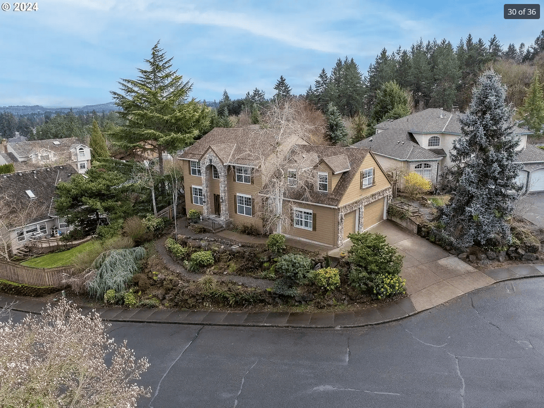

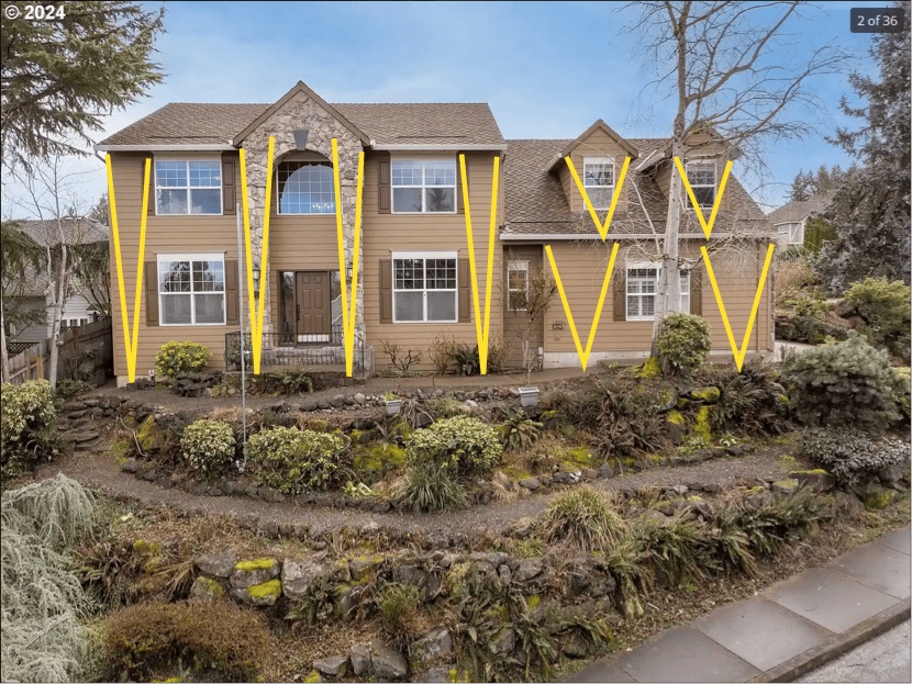

    4) Picture 3 is a more recent photo of the yard. Picture 4 is my first stab at designing a layout.
    Thanks again for any help!

    Fellow lighting enthusiast here. First, thanks for posting multiple pics and from different perspectives. Super helpful. You’ve got a nice big canvas to work with and so you have almost endless options. If you’re struggling to come up with ideas for lighting your yard, I think it might be helpful to look at similar properties online (real estate websites are great) and also walk around your neighborhood to see what lighting plans others have created. This is a good way to decide what appeals to you and what approaches to avoid. I diagrammed one of your photos to suggest one possible plan for your house. For the landscaping itself, I want to recommend some general ideas to consider.
    Depending on how much light you want to introduce to your landscaping overall, there are a lot of different ways you can highlight the contours of each level. You could start by highlighting the rock walls at each level. From there you could choose different shrubs or groups of shrubs to light, filling in each section with light in pools of varying sizes. HTH to get you started.

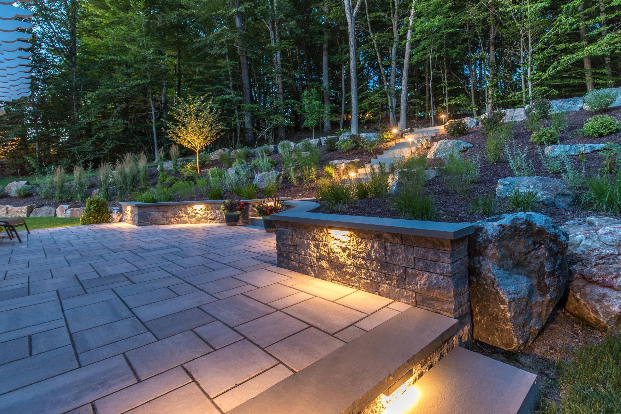

    Btw, because you’ll have fixtures mounted on different levels, you’ll want to be mindful of the specific models and types you choose. It’s usually a good idea to keep your light sources hidden. The great thing about a terraced garden like yours is that there’s lots of places you can easily conceal fixtures. In your case, I would take advantage of smaller size fixtures when possible. In particular, I’d focus on fixtures like hardscape, deck, and step lights. You’ll notice that certain fixture types (puck lights, for example) appear under multiple categories on the website. The colored lights are a great idea because they’re super versatile. Not only can you choose the different colors, you can create any white color temperature from very warm to very cool. You can also dim the lights to whatever level you choose. But the best feature (IMHO) is the ability to create multiple lighting zones. One minor note of caution is that there’s a few integrated fixture models where the light color temperature is fixed (the 10W flood, for ex.) and there may be a few other fixture models where there currently isn’t a color option available. If you see any fixture models where it’s not clear or you have other questions about their functionality, I highly recommend that you speak with VOLT customer service prior to making your purchase. HTH.

    I'm planning to go with G5 RGBW Infinity spot light fixtures (https://www.voltlighting.com/rgbcw-g5-infiniti-integrated-led-brass-spotlight) at all the "A" locations. I'm curious if you have recommendations for what style/type of light to use at locations B, C, and D. B seems like it may not need as powerful of a light to just illuminate the rhododendrons, but it's hard to estimate lumen needs/spread/etc. Would something like a G2 RGBW Buddy Pro puck be enough at the B locations? (https://www.voltlighting.com/g2-rgbcw-buddypro-brass-led-puck-light)
    - Not really sure where to start with C location.
    - D seems like maybe another candidate for the G5 RGBW Infinity spotlights, with 60deg lens.
    Thank you so much in advance for any advice you have to offer! It's very appreciated.

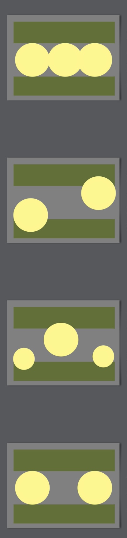

    Glad to hear my feedback was helpful, Ryan. I think I could have done a better job of explaining some of the guidance and ideas I was trying to convey in the photos I diagrammed. My goal was to demonstrate that, just as there isn't any one single ideal way to create a lighting plan for your house, there isn't any one single best way to light the different levels of your terraced garden. Some time ago, I created the image shown here, which is intended to illustrate several different ways someone might light a pathway. I pointed out that, where safety is the property owner's main priority, arranging umbrella style path lights so that pools of light are continuous (top rectangle) is often recommended. When that's less of a priority, I think people should feel free to express their creativity in whatever way they find most aesthetically appealing. If you wanted to play it perfectly safe on that second level (in the photo you posted here), you could simply highlight all the smaller boulders at the base of that planting area and call it a day. Another way you could highlight the contours of that level would be to highlight some of the boulders (C) and then illuminate some of the shrubs (I just randomly chose the three I circled) just inside of that boulder-outlined section. If, instead of those handsome boulders, you had ordinary mulch or some other unremarkable material bordering those planting areas, I might encourage you to focus solely on illuminating your shrubs, ornamental grasses, etc.
    When people are trying to decide what to light and how to light it, I encourage them to first ask themselves what it is they like or find extraordinary about their yards and then go from there. I myself am partial to trees and shrubs with bright red foliage, red blossoms, or red fruit or seeds. I love plants that have glossy leaves, I love conifers (especially evergreen ground covers), and I'm crazy about ornamental grasses. If you really like your rhododendrons and you want to be able to enjoy seeing their blooms at night, consider lighting those. When you're considering what to light, think about what different plants and trees look like throughout the year. IMO, a bare crape myrtle in the dead of winter is as stunning as it is in full bloom in the summer.

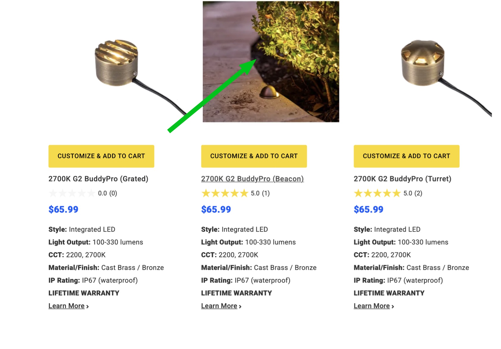

    Edit: Just wanted to reiterate that I think the fixture types you'll probably be relying on most for lighting your garden are deck lights, hardscape lights, puck lights and well lights. When choosing your lights, try to be mindful of the brightness range options for each different fixture model you choose. This is crucial because some fixtures' brightness ranges max out at a few hundred lumens, whereas others max out at more than double that brightness. I also think it might be helpful for you to spend some time understanding the visual effects produced by different fixture types. This knowledge will guide you in deciding which fixture types to choose depending on the area or feature you want to light. Consider, for example, both of the grated fixtures shown in the photos I've included here. The grates shield one's eyes, making these ideal for installs where you want the output of an uplight along a walkway or other area people routinely walk by. HTH brightness.jpg light direction.jpg
