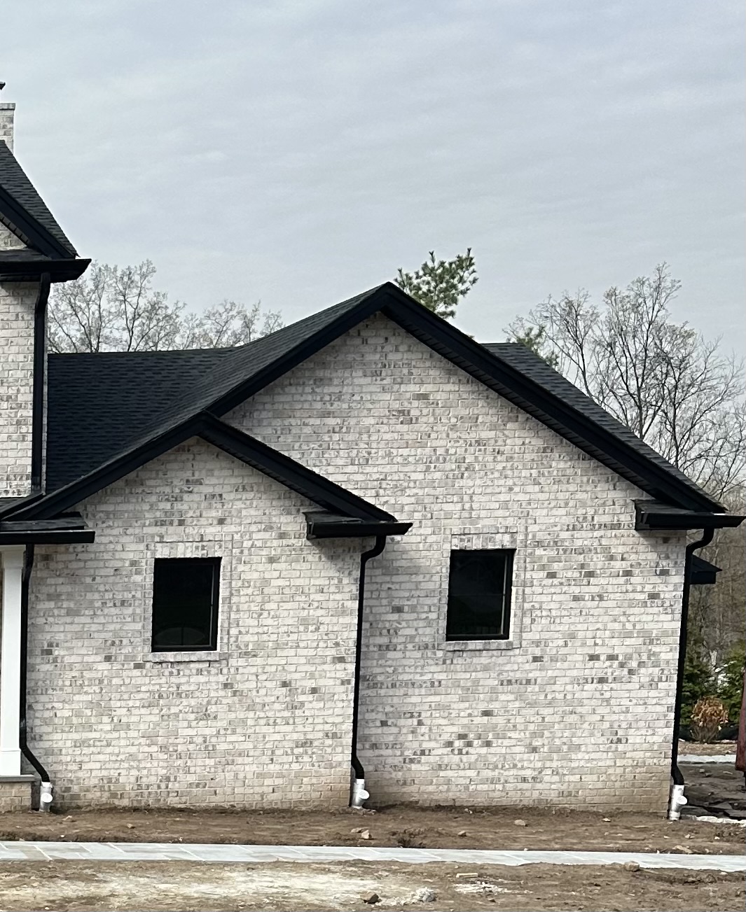

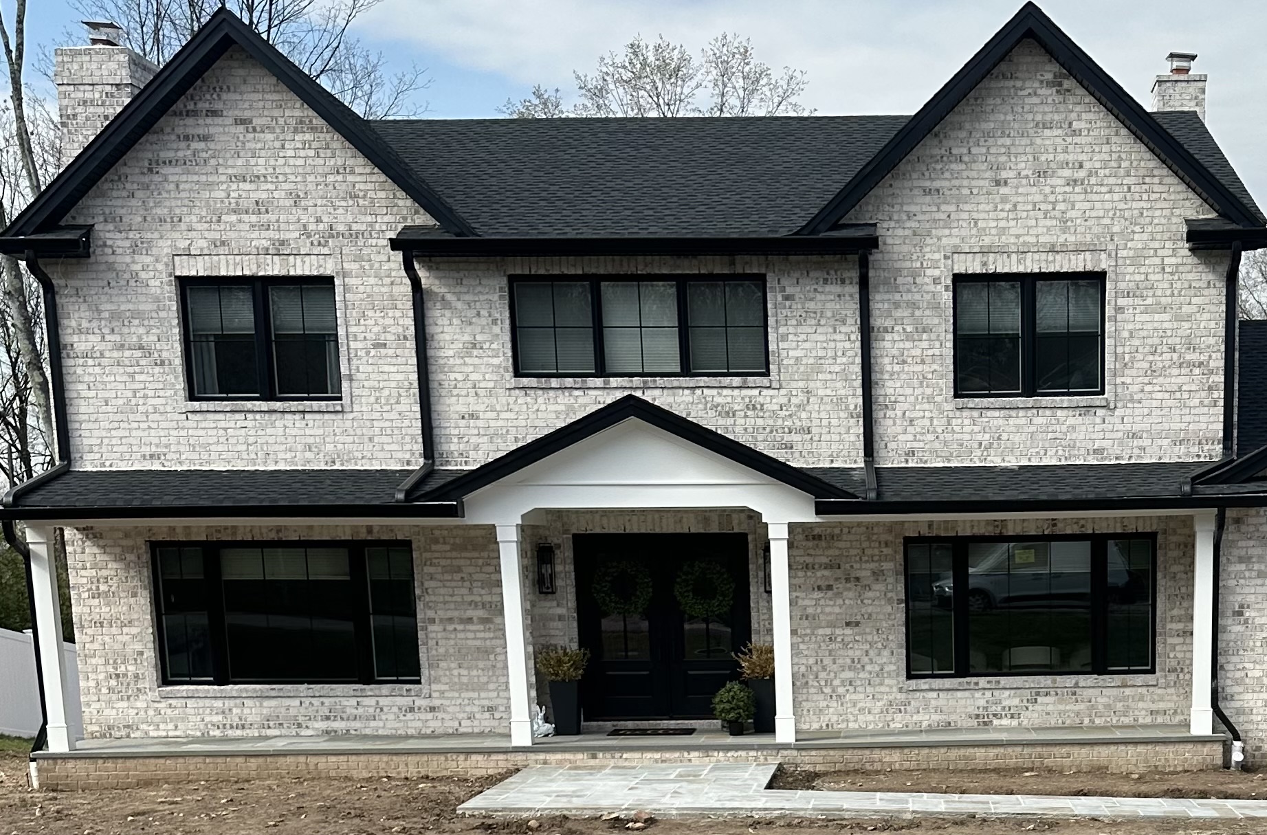

    mesodude2, thank you for your help. My imagine is two big to load as one whole picture so I broke it up into 2 imagines. House side and garage bump out side. IMG_7389.jpeg IMG_7389.jpeg

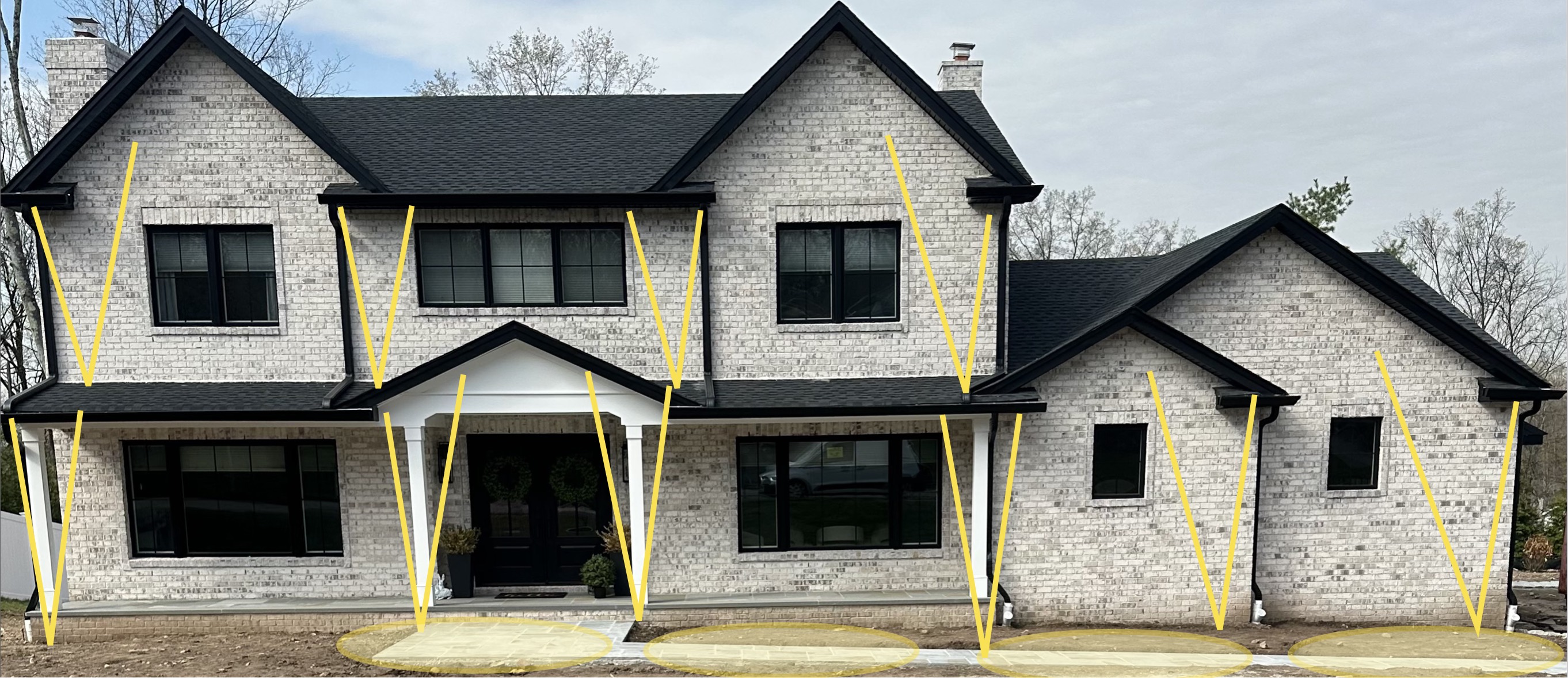

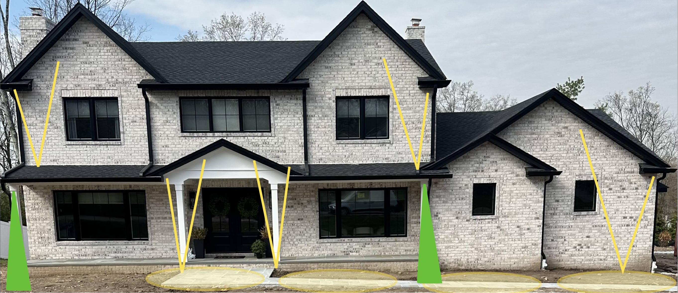

    Glad to help. You have numerous options for creating a coherent lighting plan but I’ve diagrammed your photos to illustrate just a few here. As you can see, there are many ways to define the footprint of your property and highlight the architecture of your home. Your only limit is your budget and your creativity. For instance, think about what or whether you might want to plant some shrubs in front of the two outer porch columns (see photo with green graphics) and illuminate the shrubs or trees or ornamental grass there (either instead of or in addition to) illuminating the columns. The yellow graphics are meant to indicate up lights but if the soffits/overhangs are deep enough for you to hide puck lights, you could easily include some down lights in your plan as well.
    Also consider using other architectural features to your advantage. The black roofs and gutters will make it easy for you to hide black light fixtures (if you so choose) and the black wiring that you’ll need to route up to fixtures installed on the upper level. Additional tips: if you haven’t already planted shrubs or trees near the foundation, keeping them a foot or so away from the foundation will give you more flexibility to install and aim your ground level light fixtures. Now is probably a good time to make sure you can easily install path lights or other fixtures on either side of your walkway. With light grey and black being the primary colors on your house, I would recommend 2700K color temp lights to warm things up a bit. IMO, 3000K (which is fine for your trees and shrubs) or cooler can make a house look stark or almost chilly. But that’s just me.
