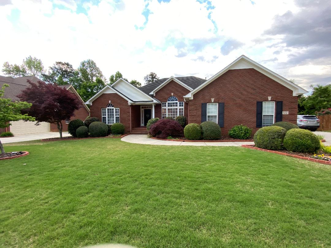

Does anyone have any suggestions on where I should place path lights and spotlights in my front yard? Any suggestions are welcome.
Lovely home, Lmdeaton1. Please see my diagram of your photo here for one possible plan. I’m basically recommending you spotlight the largest sections of your facade and the gable indicated. I think fairly narrow beam spreads (+/- 15-20 degrees) should work to highlight the brick work at the corners along the facade. And +/- 38 degrees for the section between the two windows on the right. I like the idea of you either uplighting the Japanese maple or uplighting the two narrow sections (indicated by the orange graphics) flanking that large window but I think doing both could put too much light into that area. Others may disagree. For the yard, consider uplighting both those trees indicated. Suggested path light locations are indicated by the circles. I am on the fence about a path light where the orange circle is. I also like the idea of you highlighting one of those groups of shrubs (the group on the left would be my first choice) with a mini-floodlight or two. Again, you have a lovely house and well manicured yard. IMO, you really don’t need to go with very bright lamps to create an impressive lighting plan.

My outlet is to the right of the short Japanese maple in front. I’ll have to look at my sidewalk to see if it has expansion joints. I know my driveway does.
