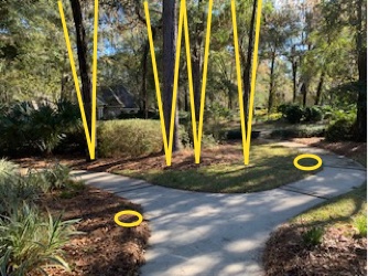

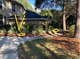

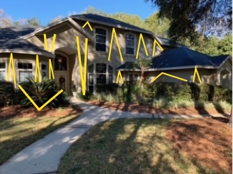

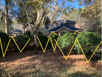

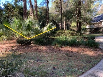

    Hi, Duke. Phenomenal home and landscaping. Unfortunately I don't have a clear sense of the overall layout of the property so I'll just offer some general recommendations. I've diagrammed several of your photos to suggest one approach to lighting the facade and I've also chosen some landscaping features that just jumped out at me. I've indicated some individual shrubs that I might illuminate and I've also indicated some groups of shrubs and trees I would light. I've also indicated some places where you might place path lights. Where you have curves or intersections along your path are obvious places to install path lights. You might want to place path lights so that they lead visitors to your property to specific areas. Ultimately, it'll be up to you to decide which parts of the property you want to show off so that you and your visitors can enjoy them at night. Because a lot of your shrubs hug the foundation of your house and because you have those nice deep soffits (where you could easily conceal fixtures and wiring), I'd recommend down lights rather than ground mounted spotlights for the facade. Puck lights or hardscape lights would work very well.
