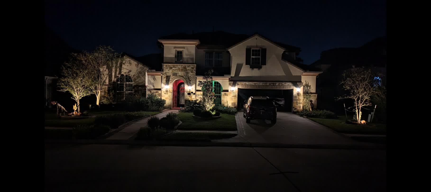

    So I got 8 G4s installed and was testing them out but not sure if I have to move them around or add more.
    I have one on each tree (4). I then have one to the left and the right of the entrance. And then one to the left and right of the garage
    Currently they all still have their 60° lens on but I have 38s to swap.
    Also not photoed our our pathway lights which I installed but I don't need help with those.
    Any help would be great.

    This is not exactly in my wheelhouse but it seems to me that experimenting with the narrower beam spread lamps is a good idea.Are you going for bands of light or pools of light? Are you also looking at the light output/effects created by each fixture by itself (to get a clearer idea of what the final plan will look like)?

    The trees are the way I want them so that's fine.
    It's the house that I am having a little trouble with. I put the lights where I think they should go to at least illuminate some of the areas. Some of the areas as you can see about mid way up jut out a little where the brick or Stone then transitions to the stucco. I then have that second floor window that's set back.
    If I was starting from scratch where would you put lights on the house and at what beam? I can again always move them around or add more if I need to the second floor.
    Do you think it looks okay so far?

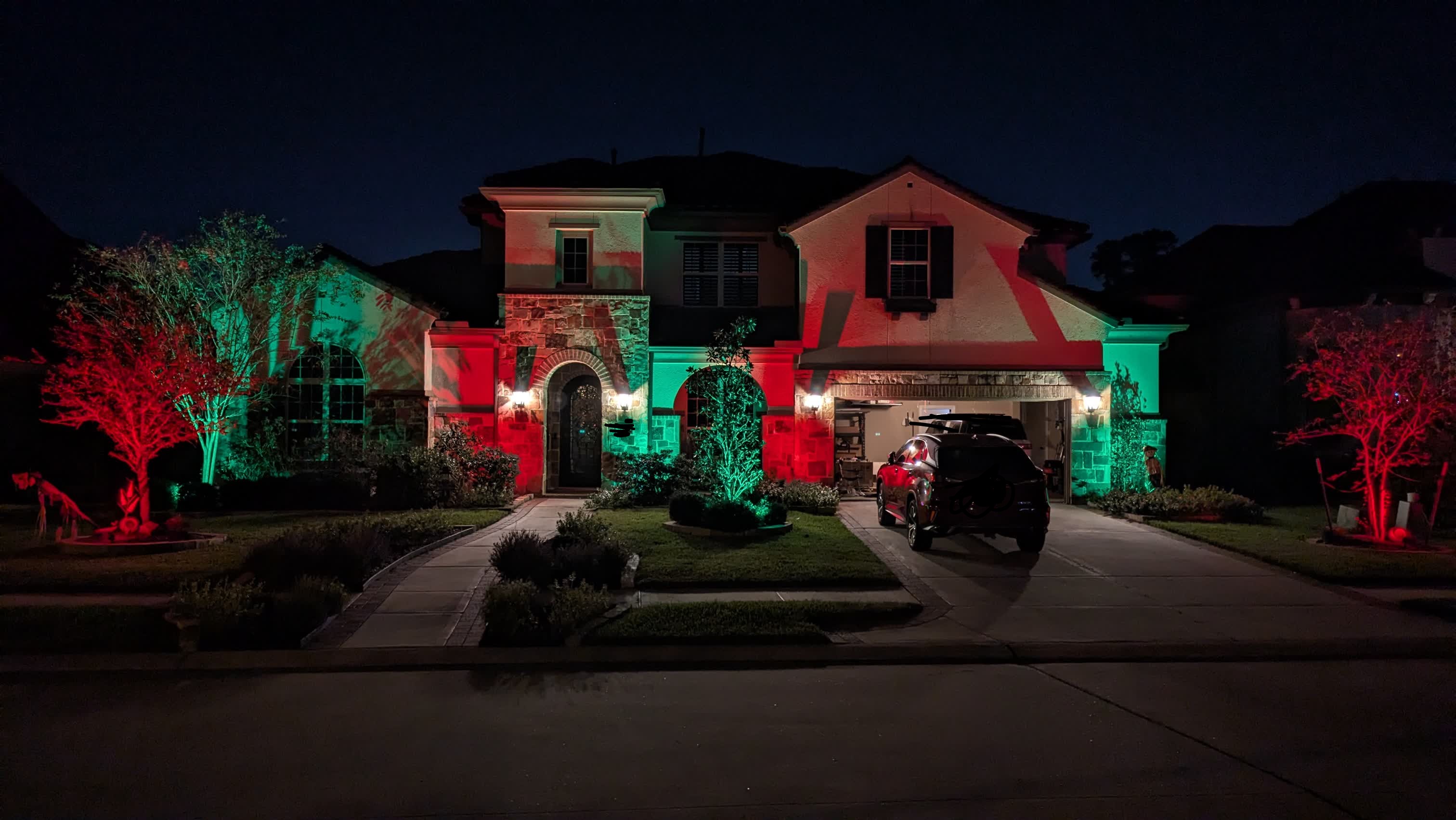

    Here are two photos of when my year-round lights are on in warm White. It's not as bright in the second photo as it looks and more subtle like the first.

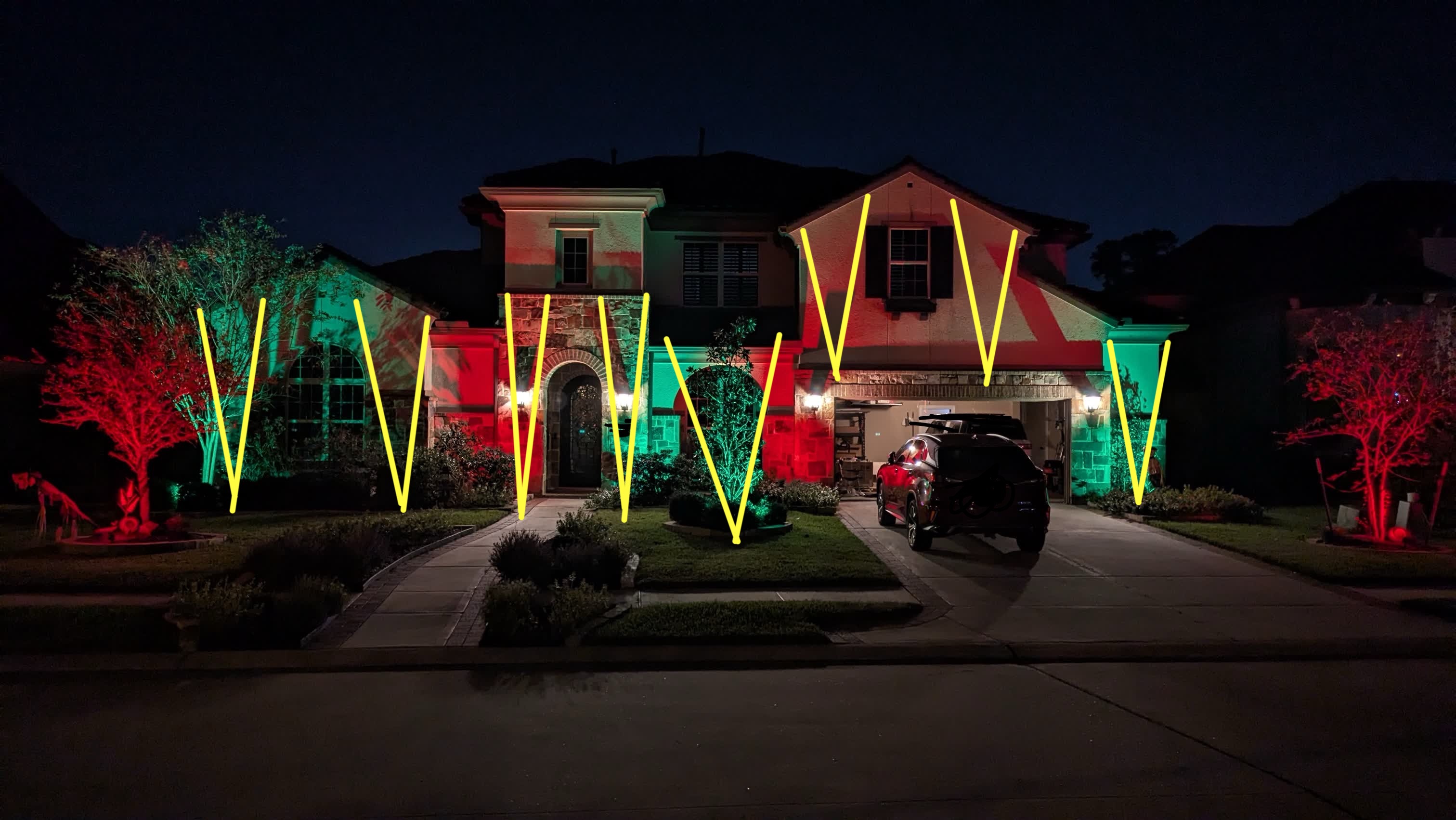

    With your sconces on, it’s a bit hard to see what’s going on everywhere. But what I can see looking at your house facade is that the 60° beam spreads appear to be overlapping one another somewhat. If I were starting from scratch, my plan might look like the one here in your photo which I diagrammed with yellow graphics.In most cases, I wouldn’t go higher than about 40°. For the narrow stone areas flanking your arched main entrance, I would go fairly narrow (in the 20° +/- range.

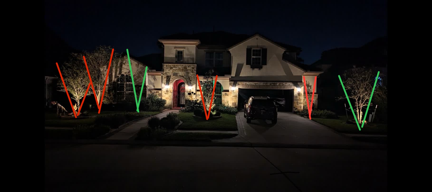

    If I were using colored lights that are dimmable and that allowed me to choose from among a gazillion colors, I might be a bit adventurous but what you have is a good start, imo. I would also focus on my trees and shrubs more so than my house. In my second photo, the colored graphics are meant to indicate where I might place colored lights throughout the yard. HTH
