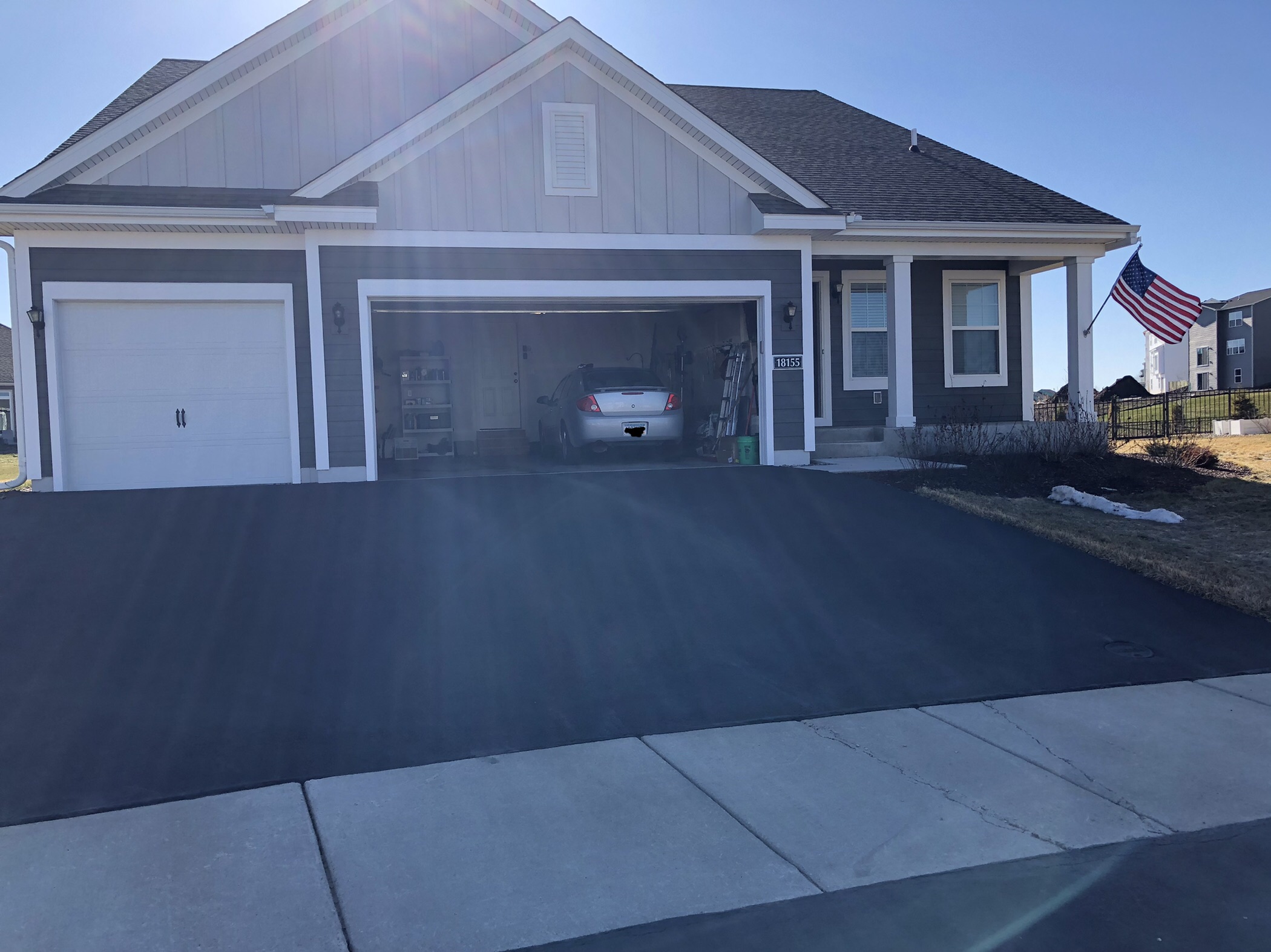

Hello, I’ve been learning a lot reading through the forum. Kinda stoked there are so many gurus around to lend an ear! My wife and I are doing some major additions to the back yard so I wanted to class up the front too. Been thinking about the All Star mini (or all star) but could use some help with placement, bulb wattage, and beam angles. I was thinking of uplighting at the posts, a couple spots lighting the garden, and maybe a bigger spot pointing up on the gable. We will be redoing the garden area with some non-builder plants. I don’t have a better pic on hand but there’s not much more to the front yard lol. Most of our lot is in the back. I’d welcome any thoughts on where to begin as I’ve never done lighting before, but I can handle the implementation if I get some direction. We’re going for more of a subtle set up, but still something that will class it up a notch. TIA!
Hi Foxtrotbravo. You have a charming home and I agree that you can enhance that charm by lighting it in an understated way. I diagrammed your photo to suggest one possible approach. With most of your facade “landlocked” (with asphalt or concrete meeting the foundation), I suspect your biggest challenge will be figuring out the best way to route and conceal your wiring for house mounted fixtures. My approach is fairly straightforward. You’d light the columns from above (with puck lights mounted on your soffit) or from below using staked fixtures. Puck lights would illuminate the columns and your foundation plantings. With lights in the ground, you could isolate the columns by going with narrow beam spotlights (15-25 degree range would be my suggestion). I’d also illuminate your flag from the ground as well. I’d go with 38 degree spotlights (minis would work well) on each of the gables. Your garage doors fill 2/3 of the lower facade of your house. If you can figure out a way to conceal the wiring effectively, I’d go with either puck lights or hardscape lights to illuminate your garage doors. Finally, it appears you have at least four wall sconces. If you want those to be part of your lighting plan, I might forego the garage door lights and go with fairly low lumens bulbs to subtly light those sections of your facade. One advantage of having a house where you can easily and safely access an upper level is that mounting fixtures is not as daunting as with taller multi-level homes. That’s something to keep in mind whether you DIY or hire a roofer or electrician or landscaper to do the work.
