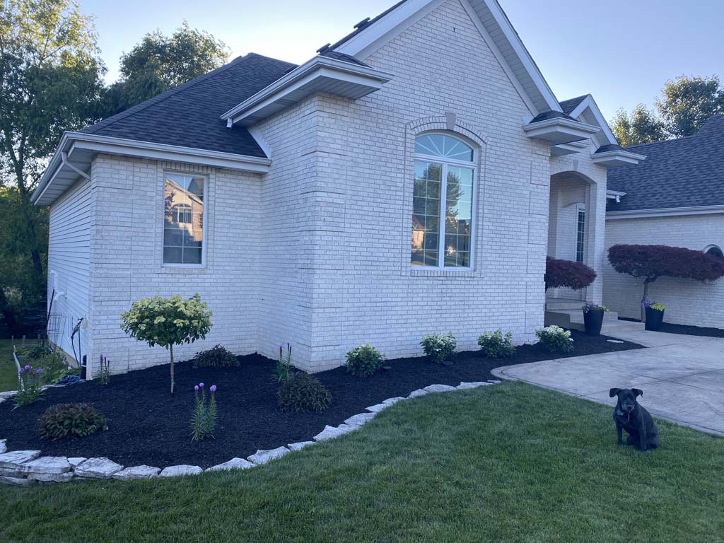

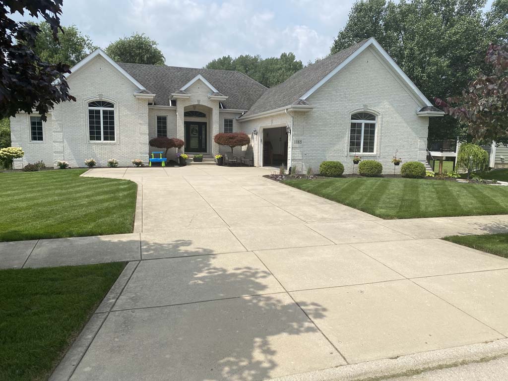

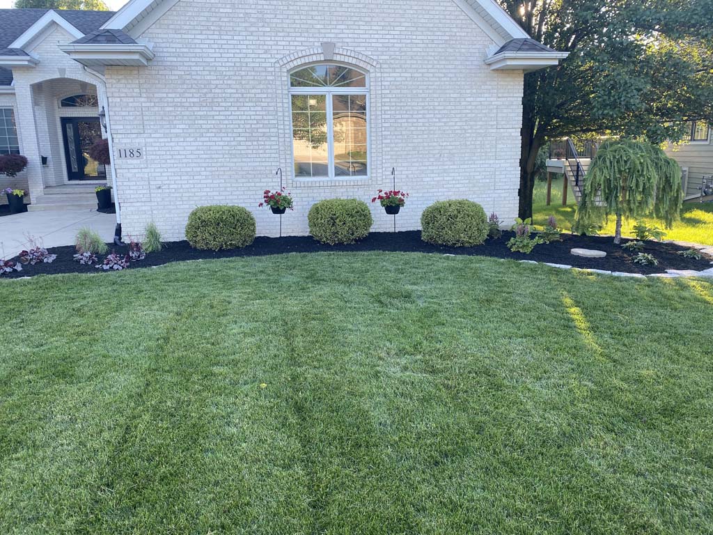

We ripped out a bunch of landscaping at our house and have finally replanted some new shrubs and are looking to add some lighting. The main issue is the front of our house is dark and I think some landscape lighting would be a great way to lighten it up from the street. We normally come down the road from the right side of the pictures, and with the "L" shape of our house, the front right side is very dark with the only lights being the front porch and garage. I have a rough idea, but would love some input. I want to keep all the lights on the ground, no new soffit lights or anything, if possible. I'm thinking a kit of the G2 spotlights with some extra G2s would be perfect for this project. I have a outlet right behind the boxwoods on the right side, and I have expansion joints in the driveway to run wire to the left side of the house. A quick question on the kit, do the G2s come with the 25' hub cord since the kit comes with the hub, or do they have the 4' cords? I'm thinking about lights on the 2 Jap Maples, the Larch. Then I really need the lights on the front of the garage because that's the darkest area of the house. The 2 windows to the left are both bedrooms so I think a narrow beam on those to keep the light out of the windows as much as possible. Do I add another uplight in the left corner where the house jots back? Would a path/ground light right behind the Hydranga tree look ok? Should I do uplights on the front porch pillars since I would already have lights on the jap maples? Maybe some sort of inground light there to hide them a bit more? I keep the maples trimmed back, but they might be a bit too big and block the uplight onto the pillars.... Should I put some sort of path lights around the boxwoods to give that area some light? Maybe around the coralbells and/or around the Larch/Astilbe/lungwort?

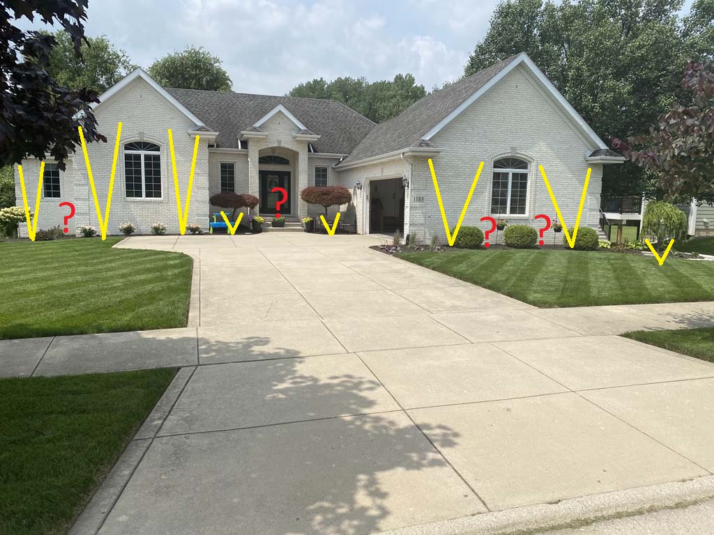

Your plan looks great as is, aclark. If you wanted something lower key than lighting the larger areas of the facade, you could also simply focus on highlighting the brickwork at the corners of your house (see my diagram of your photo here). Now to your questions... Please don't quote me but I believe the 25' wire is standard on all the spotlights that are part of a kit. If you were to buy them a la carte, a 4ft option is also available. Your goal is to come up with an attractive and cohesive plan. Because your house is lightly colored and not very tall, I think you should find that either your existing plan or the alternative I suggested provide sufficient lighting. Bear in mind that you'll get lots of reflected/bounced lighting. That might be enough to sufficiently highlight areas behind your shrubs. When looking at the kit specs, I noticed that they now include the lamp with the 20/40/60 beam spread option. Hopefully that flexibility will give you some peace of mind as you're making your purchase. If you can effectively light the porch pillars, I'm sure they'd look great. But I also think lighting both of the maples would by itself look stunning in your entryway. You mention the other lights you have on the house and I definitely think you'll want to keep those in mind when deciding how much additional lighting you want to introduce to your landscape. HTH
